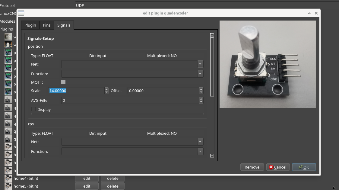

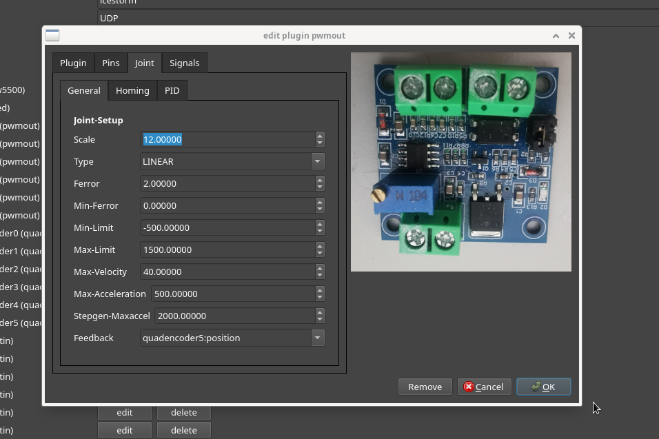

Quick question hopefully, I'm setting up my router with closed loop to the controller, apart from getting the scale right it's all working, my question is when you setup the scale in the pwm/dir config, it sets up the axis "scale in" to that, but leaves the scale out value at 1 or zero (can't remember exactly). At this value the axis will run away similar to having the encoder wires around the wrong way.
I can set it using the machine calibrate window within Linuxcnc but it gets overwritten every time setup is run. Then if you forget about it and an axis is close to end of travel, bad things can happen.
I've most likely just missed where to put in the scale out value but I can't seem to find it.
Cheers.
Russell.

Ahh awesome thanks.
