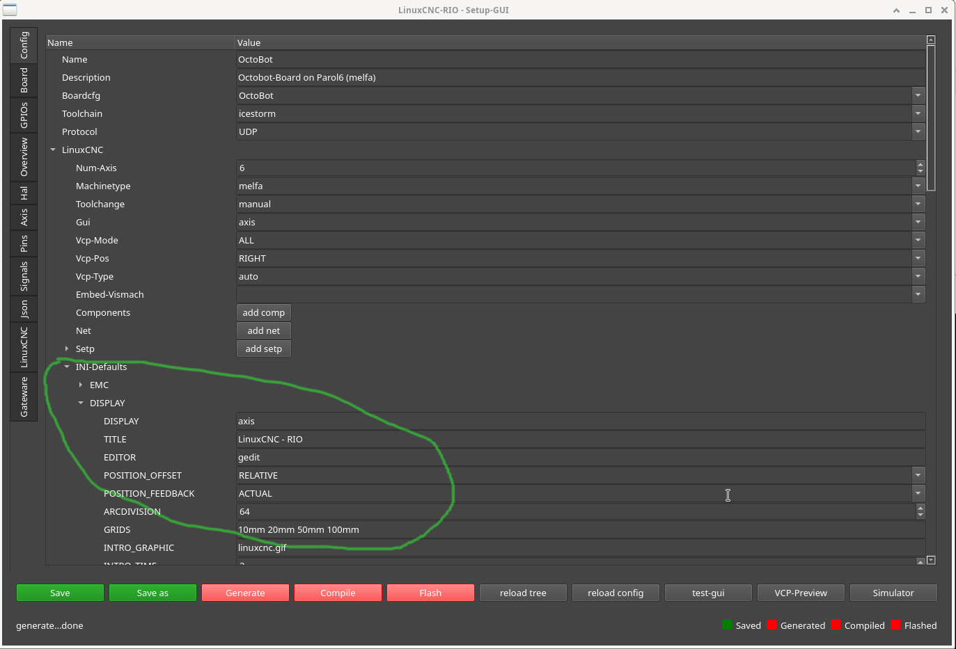

29 Jul 2025 06:03 #332508 by meister
you can also set the ini defaults in the setup gui:
