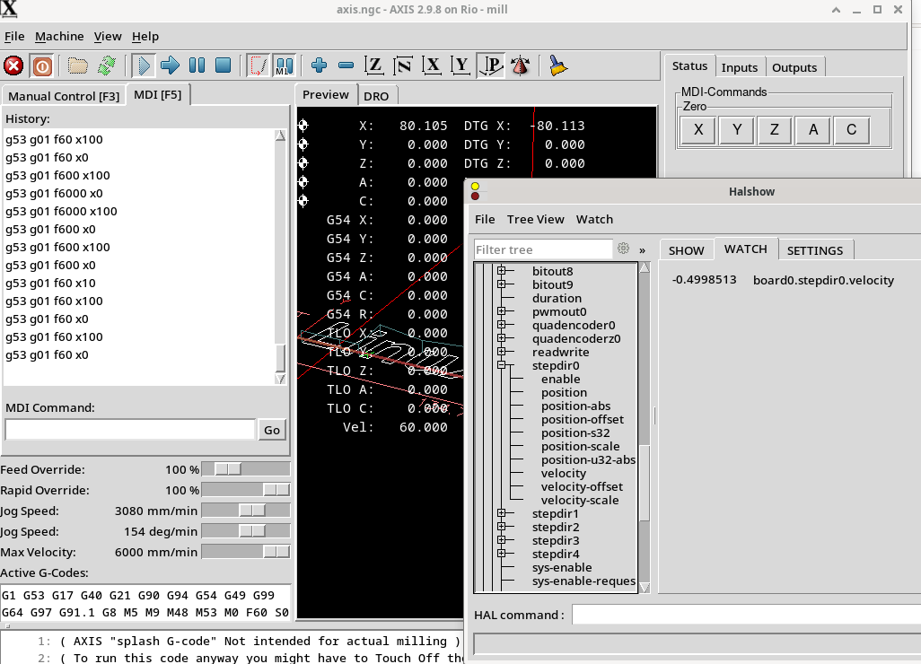

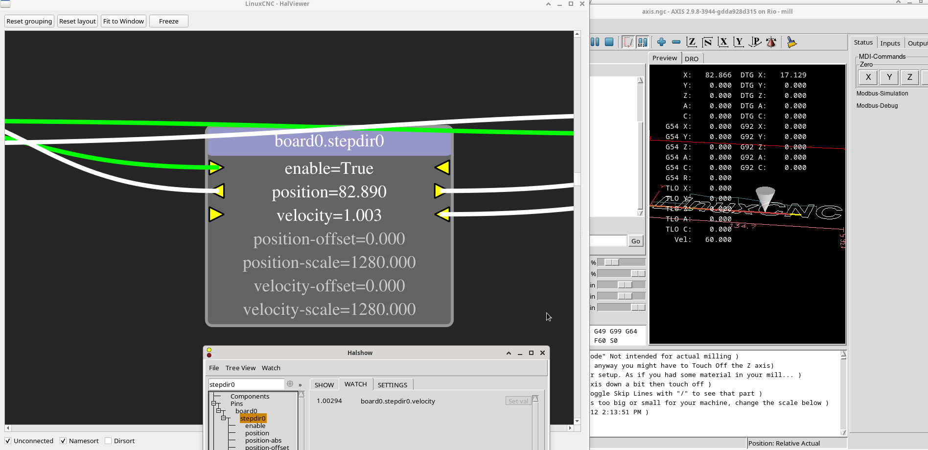

very strange
i can only test in simulation at the moment, can you try it also in simulation mode please !?!
bin/rio-generator -S carrot.json
- Tim Bee
- Posts: 31
- Thank you received: 13
21 May 2026 09:07 #346530
by Tim Bee
Replied by Tim Bee on topic LinuxCNC-RIO - RealtimeIO for LinuxCNC based on FPGA (ICE40 / ECP5)
Dear meister:
In simulation mode the velocity is 1, the result is correct
Tim
Tim
- meister
- Posts: 805
- Thank you received: 502
21 May 2026 14:32 #346536
by meister
Replied by meister on topic LinuxCNC-RIO - RealtimeIO for LinuxCNC based on FPGA (ICE40 / ECP5)
many many thanks !
found the problem, fixed in main and dev branch.
please update your gateware.
The PID controller had compensated for the fault during operation, so I never noticed it

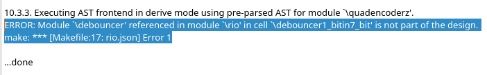

many thanks again
fixed in main/dev
I recently made a modification that only copies the modifier files to the Gateware directory when necessary,
but I didn’t realise at the time that some of the filenames are slightly different (debounce -> debouncer.v / pwm -> pwmmod.v)
fixed in main/dev
