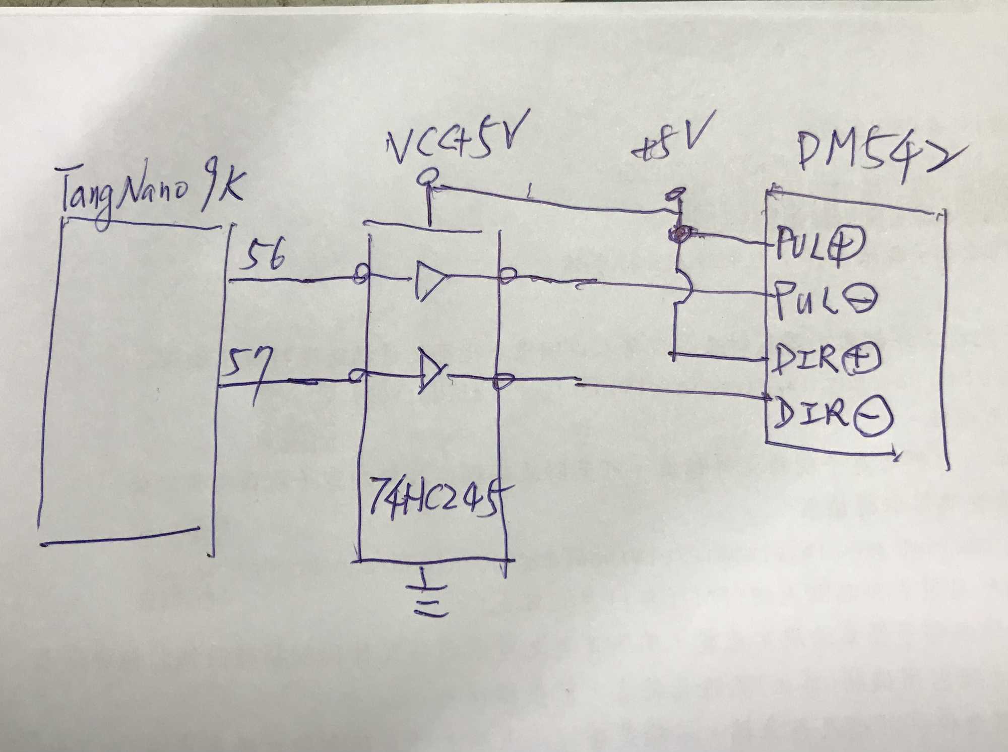

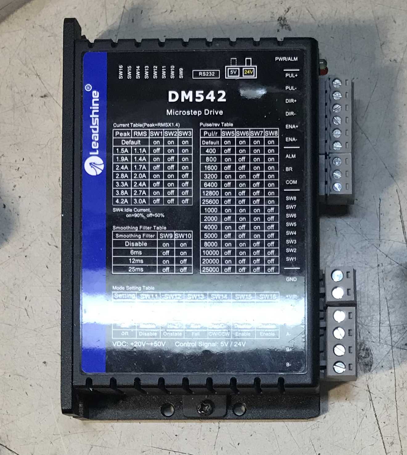

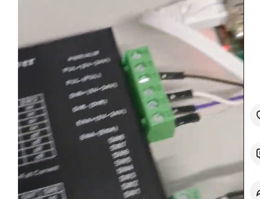

12 Aug 2026 14:38 #348667
by meister
Replied by meister on topic LinuxCNC-RIO - RealtimeIO for LinuxCNC based on FPGA (ICE40 / ECP5)
Sometimes it can be an advantage to be a bit lazy
Otherwise, I wouldn’t have been able to reproduce it.
At first, I had the driver connected directly to the TangNano9k (3.3V),
then I had a quick Google to see if anyone else was having problems with the DM542. Yes, they were, because of the 3.3V. Now I’ve connected it to the Tangoboard with 5V signals and everything’s working perfectly, with the default settings
www.youtube.com/shorts/3IeqAu58WdI

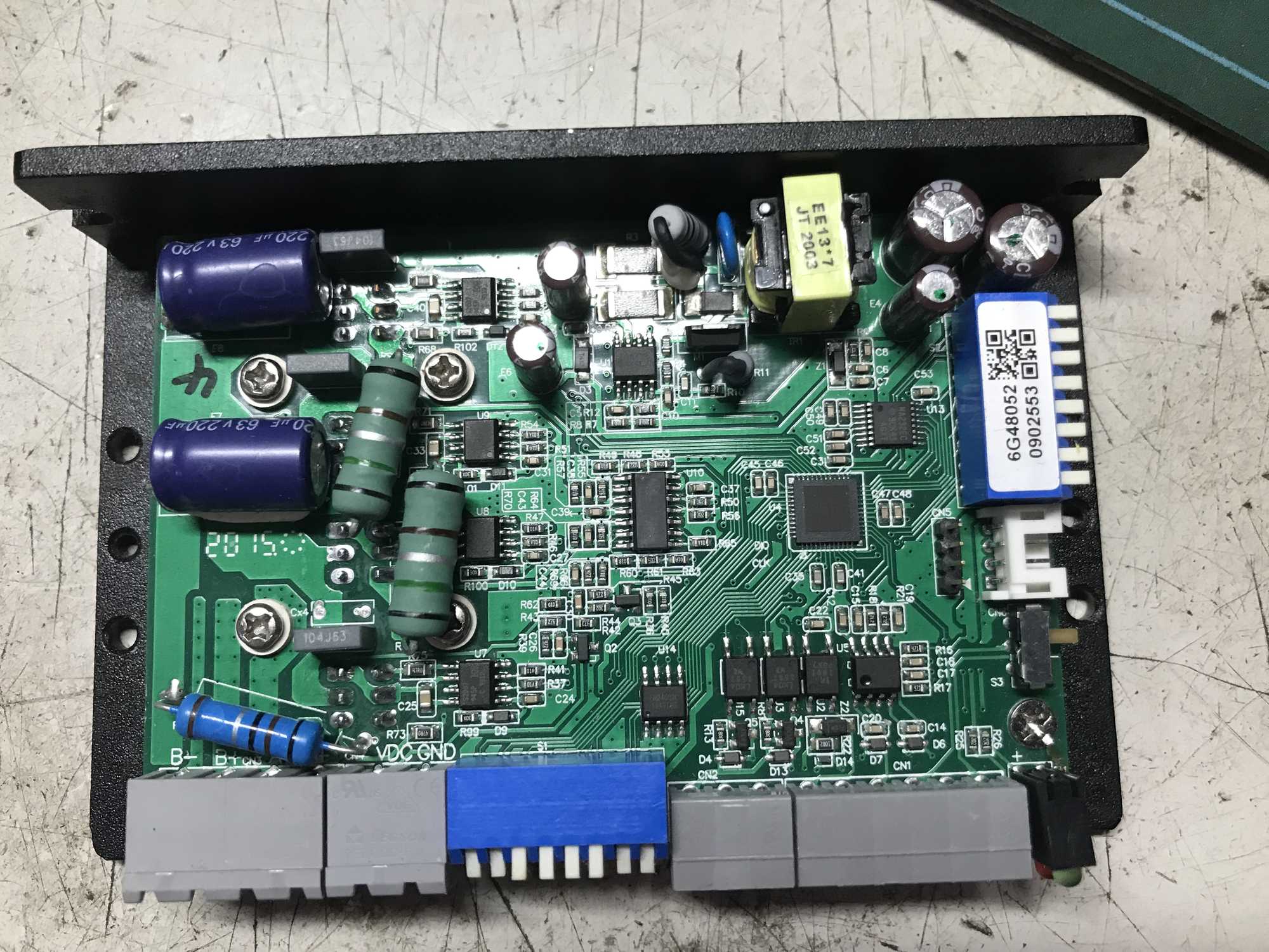

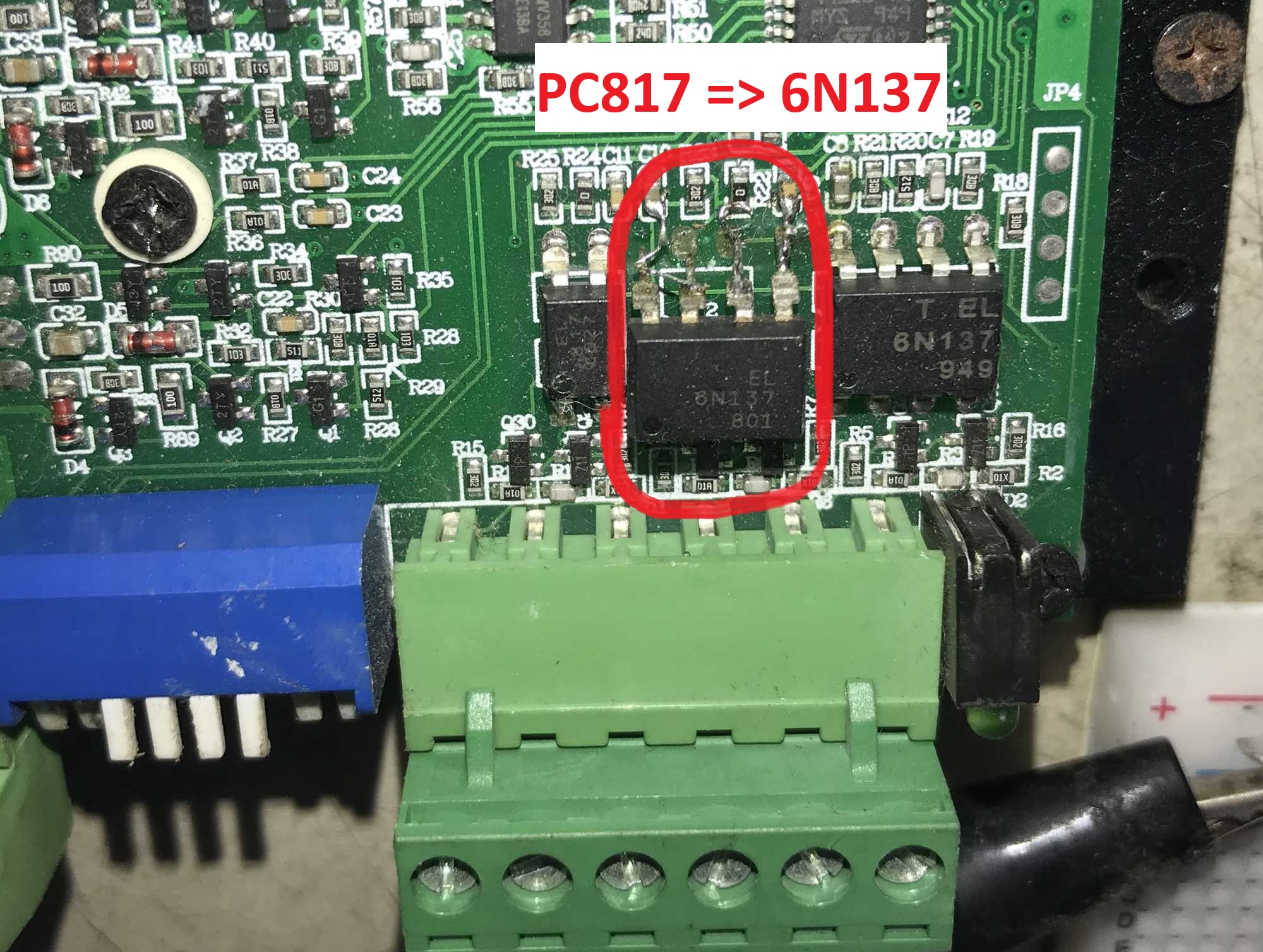

13 Aug 2026 01:02 - 13 Aug 2026 03:13 #348681
by viewsat
Replied by viewsat on topic LinuxCNC-RIO - RealtimeIO for LinuxCNC based on FPGA (ICE40 / ECP5)

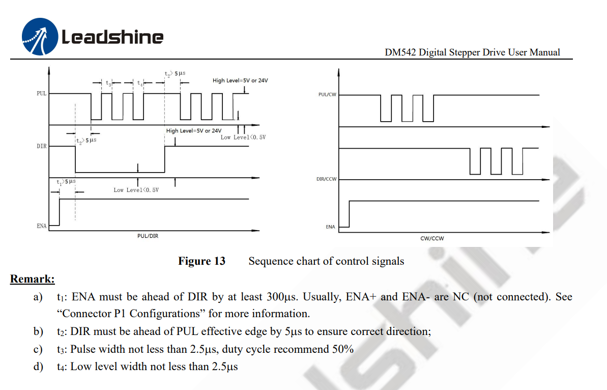

If I replace the DIR PC817 optocoupler with a high-speed 6N137, it can correctly return to the zero position.
However, using grbl and mesa 7i92 does not require modifying the DIR pc817.
I may need to use a logic analyzer to observe the timing diagrams of the Tang Nano 9k output pulses and DIR
I'm from Taipei, Taiwan, and my English isn't very good.

13 Aug 2026 03:32 #348683
by tuxcnc
By modifying the driver, you risk damaging it and reducing its reliability.
Although the PC817 has a very low bandwidth, the correct solution is to increase the dirhold.
Replied by tuxcnc on topic LinuxCNC-RIO - RealtimeIO for LinuxCNC based on FPGA (ICE40 / ECP5)
This is wrong way.If I replace the DIR PC817 optocoupler with a high-speed 6N137, it can correctly return to the zero position.

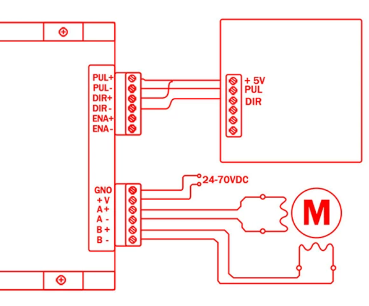

13 Aug 2026 04:29 #348685
by meister
All my positive terminals are connected to the purple cable via a thin wire.
Dirhold isn’t the problem; it really is the voltage that’s coming through – there was a clear difference between 3.3V and 5V.
My connections are like in your image, but with EN connected.
You could use a multimeter to check what voltage is coming through your DIR pin.

13 Aug 2026 06:23 - 19 Aug 2026 07:45 #348686
by viewsat
DIR/PULSE issue resolved, thank you!! (2026-08-19)

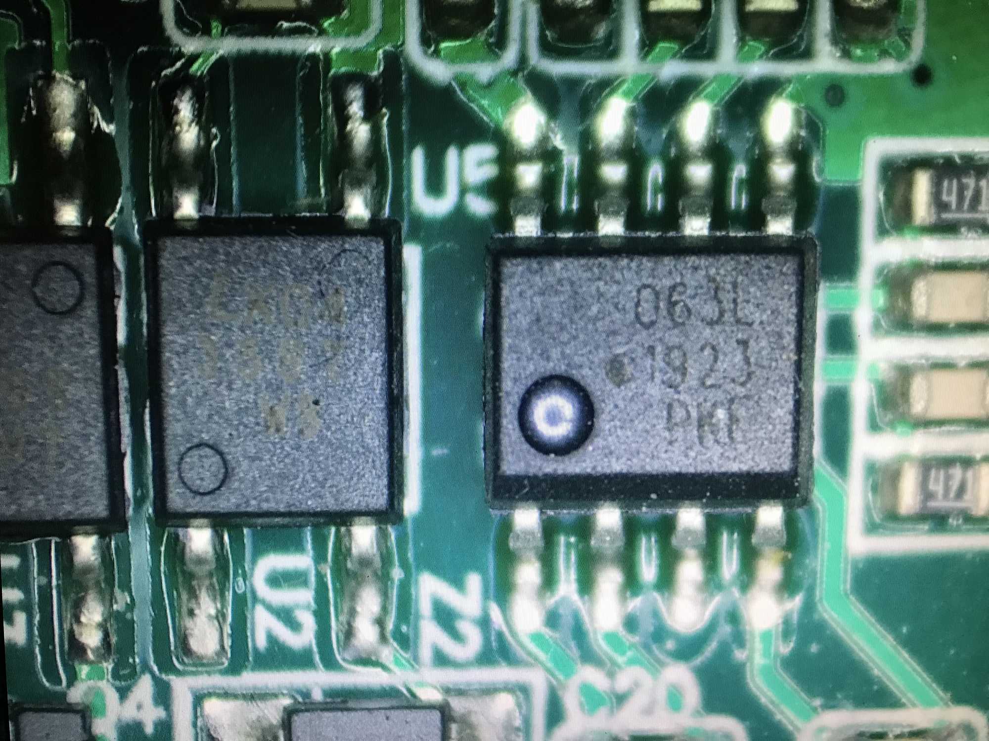

Hi tuxcnc
I tried increasing the dirhold (PULSE=10, DIR=25) but it still didn't return to the origin correctly. When using a stepper motor, I pay attention to the Sequence Chart of Control Signals. If I use a Leadshine DM542 uses HCPL-063L/15MB high-speed optocouplers for both the DIR and Pulse inputs, so there are no problems using it.
Because increasing the dirHOLD time should have solved the problem, but it didn't. If Riocore hadn't fixed the DIR issue with the cheap DM542 driver mentioned earlier, I could only replace the pc817 with a 6N137. However, I still really hope that Meister will pay attention to this problem.
Hi tuxcnc
