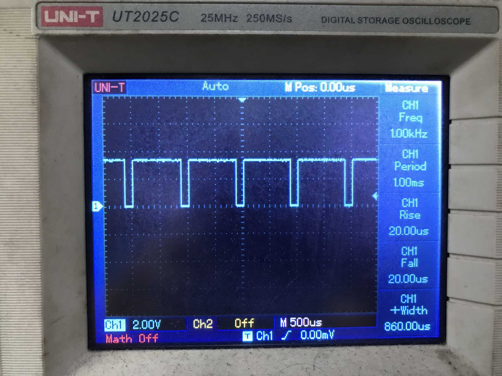

Replied by viewsat on topic LinuxCNC-RIO - RealtimeIO for LinuxCNC based on FPGA (ICE40 / ECP5)
The JSON file has been uploaded.
- meister
- Posts: 804
- Thank you received: 501

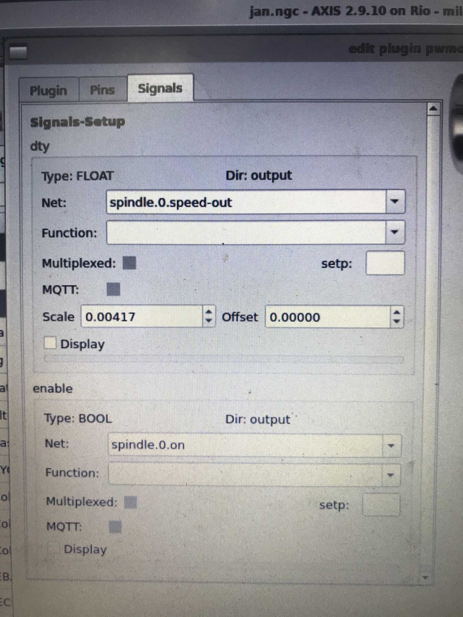

31 Jul 2026 13:51 - 31 Jul 2026 13:52 #348289
by meister
Replied by meister on topic LinuxCNC-RIO - RealtimeIO for LinuxCNC based on FPGA (ICE40 / ECP5)
ahh, sorry, you need to set the scale (signals/dty)
if your spindle max speed is 20000rpm, you need to set it to 0.005
# 100 / 20000 = 0.005
EDIT: will try to add a little helper-tool for easy setup

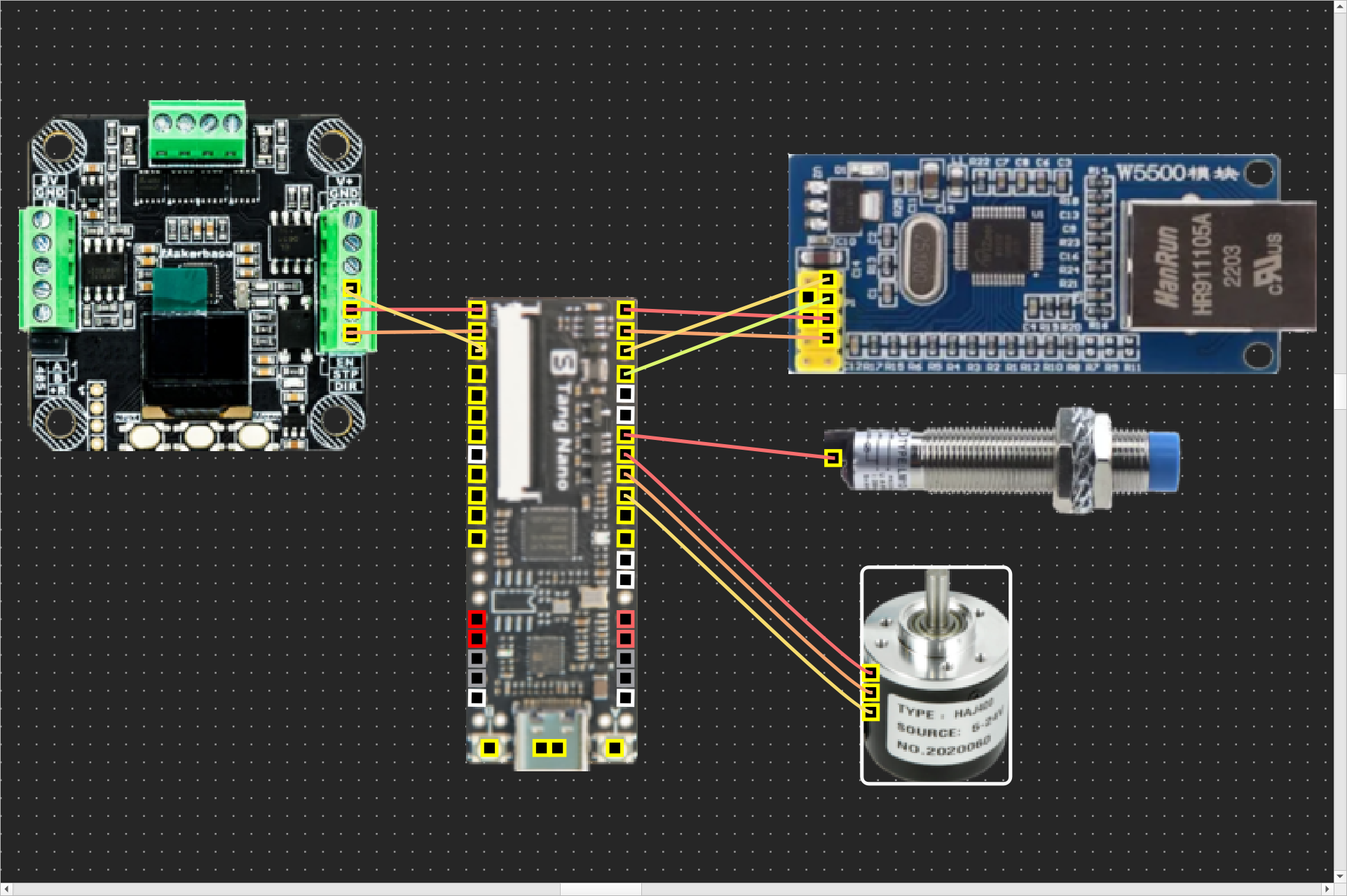

I have a question.
At github.com/multigcs/riocore/blob/main/ri...ugins/fpga/BOARDS.md TangNano1K is marked as supported.
I know 1k gates is few, but is supported.
But I can't find any stuff for this board at repository.
I wonder is it possible to use this as one axis controller.
For example in situation when somebody have got working machine and could not make any changes to it, but needs to add 4/5th axis, rotary table, tools magazine or something similar.
- meister
- Posts: 804
31 Jul 2026 17:36 - 31 Jul 2026 18:49 #348300
by meister
You’re right, it’s actually too small for a full setup.
But you could use it, for example, as a satellite, as an extension or for a distributed setup.
www.youtube.com/shorts/2vjq0Kd5WOE
In principle, a single-axis setup would also work, though it’s always a bit tricky to have mixed setups.
I’ve done a test compile:
Resources | Usage | Utilization
Logic | 956/1152 | 83%
and it fits
with USB/Serial it's to slow.
EDIT: BTW, the boards in the list are just the ones that have pre-defined pin assignments and can therefore be used easily in the Flow frontend. However, it’s also quite easy to add new boards, or you can let me know which ones you’d like to see included – as long as the FPGA supports them, it’s no problem.

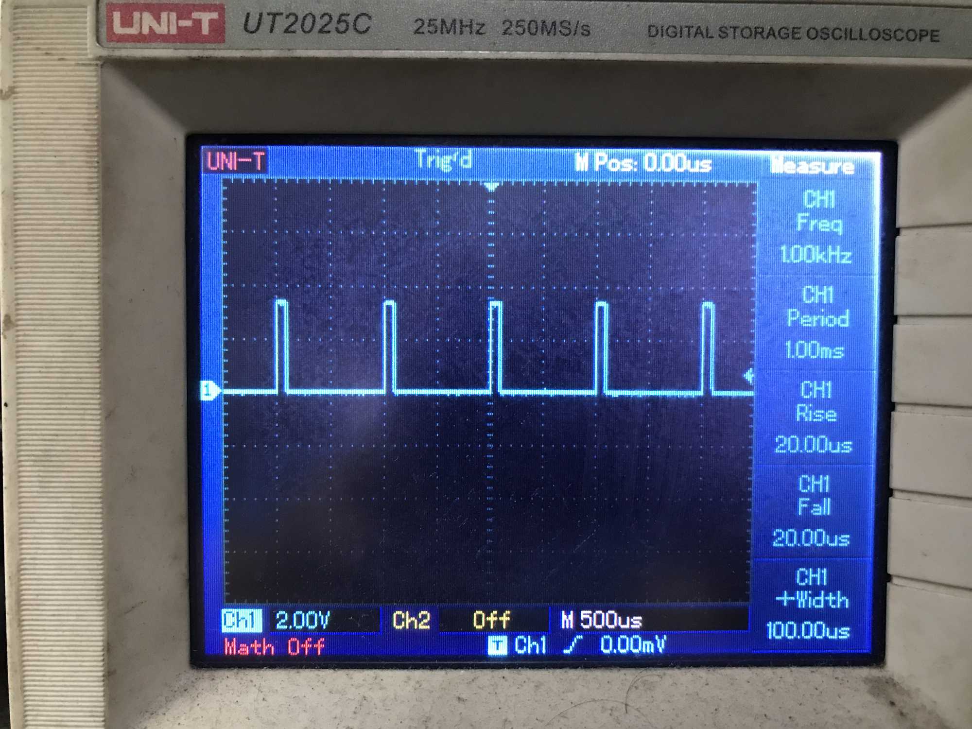

06 Aug 2026 01:21 - 19 Aug 2026 07:40 #348476
by viewsat

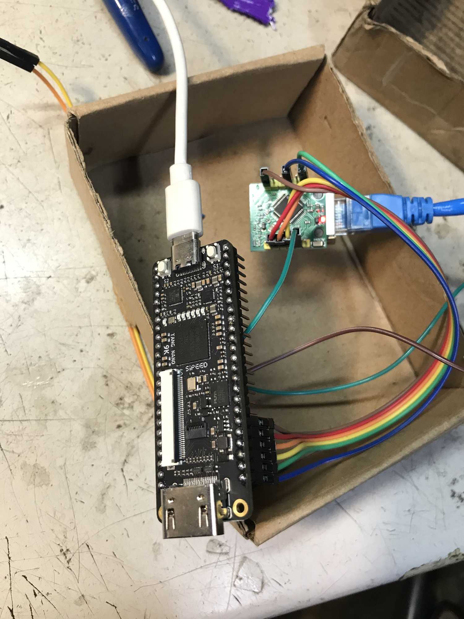

DIR/PULSE is working fine, problem solved, thank you!!
I'm using the DM542 Microstep Driver shown in the photo, with a Tango Nano 9k FPGA. After executing a set of gcode in Linux CNC, there's an error in returning to the zero-point position. However, I can correctly return to the zero-point position using a Mesa7i92.
