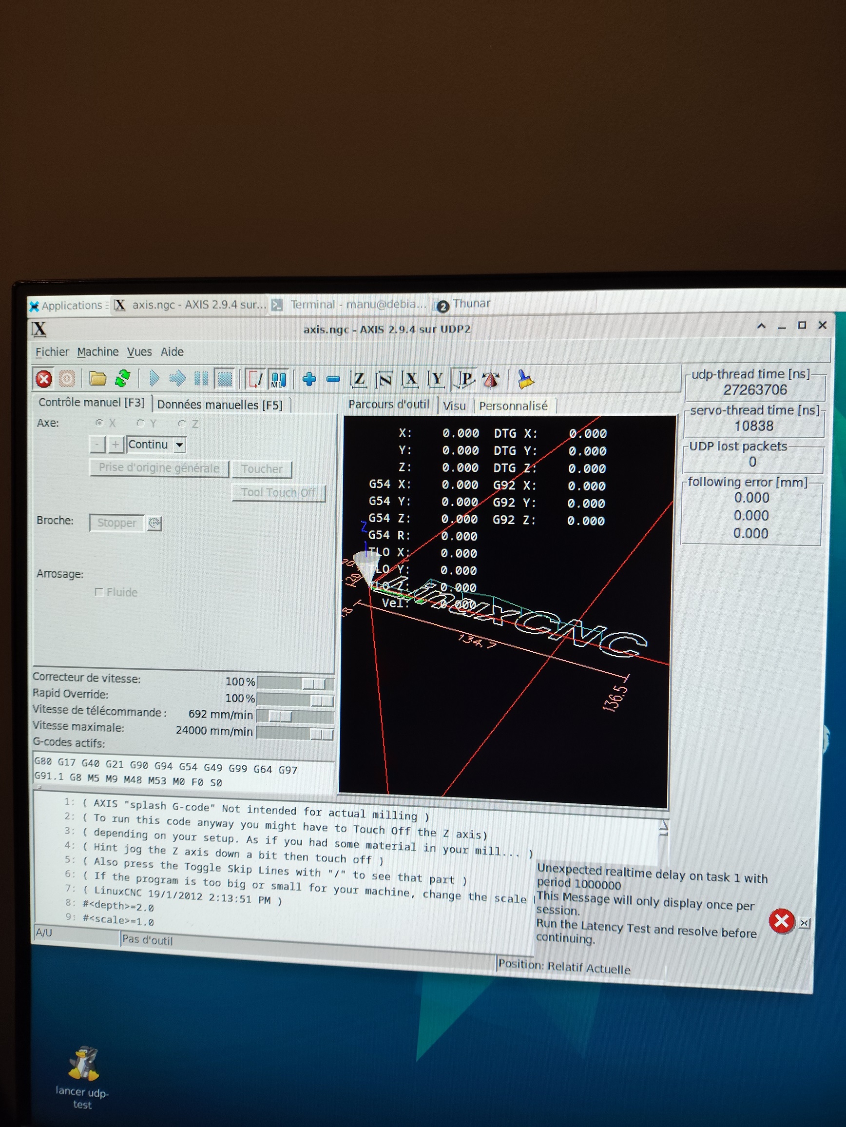

09 Jun 2025 04:54 - 09 Jun 2025 04:56 #330004
by beauxnez
[code][HOMEMOD=
TASK=milltask
HALUI=halui
DISPLAY=axis
COORDINATES=X Y Z
KINEMATICS=trivkins coordinates=XYZ
Starting LinuxCNC...
emc/iotask/ioControl.cc 786: can't load tool table.
twopass:invoked with <> options
twopass:found ./UDP2.hal
twopass: Error in file ./UDP2.hal:
setting parameter 'udp.0.dirsetup' to '20000 #100000'
parameter or pin 'udp.0.dirsetup' not found
Debug file information:
Note: Using POSIX realtime
3725
Stopping realtime threads
Unloading hal components
Note: Using POSIX realtime/code]
Replied by beauxnez on topic ESP32/S2/S3 LinuxCNC Controller (6 axis hardware step gen), USB plug-and-play
I have an error message[code][HOMEMOD=
TASK=milltask
HALUI=halui
DISPLAY=axis
COORDINATES=X Y Z
3725

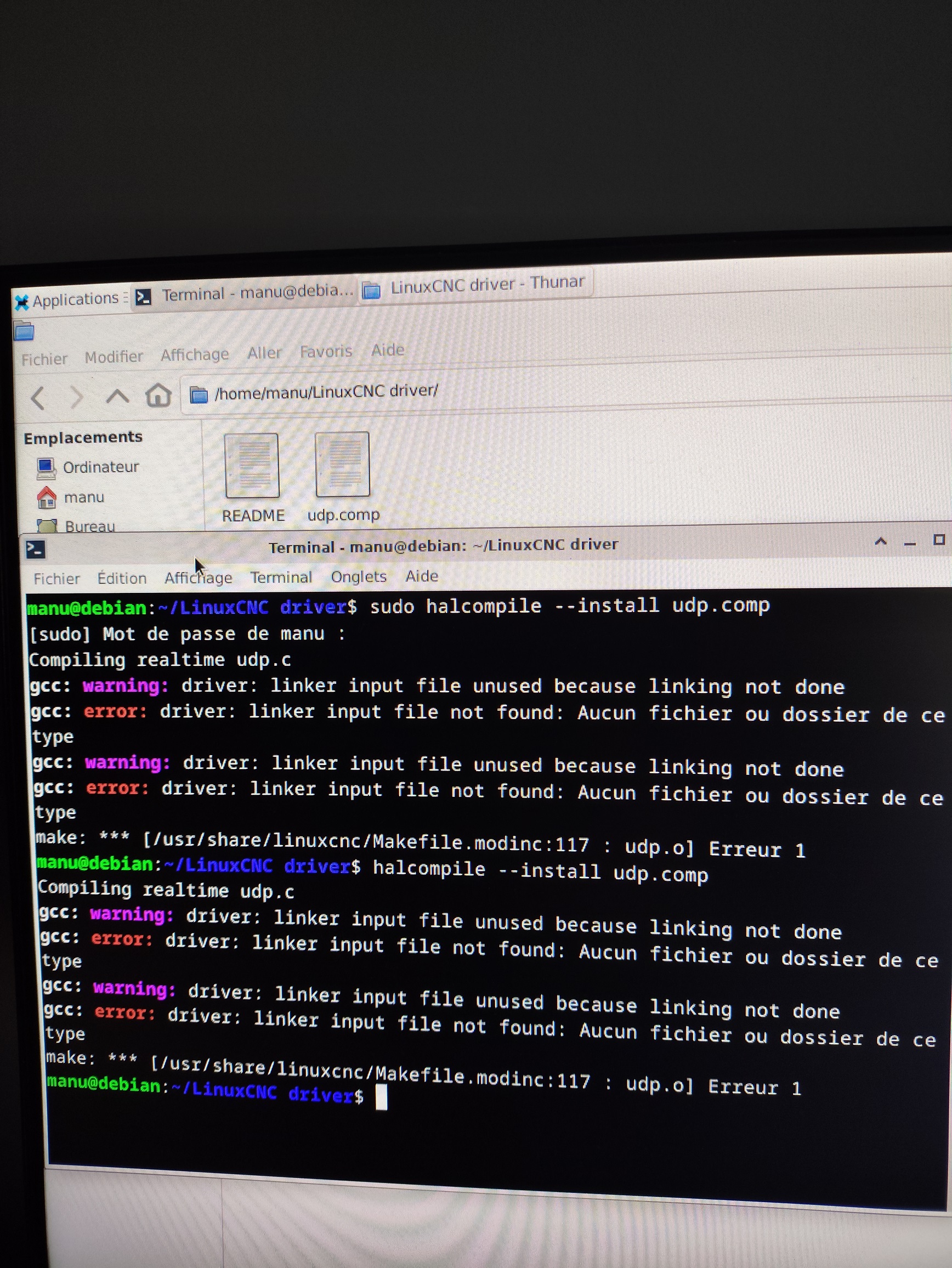

- Posts: 22048
- Thank you received: 7506
09 Jun 2025 09:17 #330020
Replied by tommylight on topic ESP32/S2/S3 LinuxCNC Controller (6 axis hardware step gen), USB plug-and-play
You have to compile the component again.
- beauxnez
- Posts: 149
- Thank you received: 10
09 Jun 2025 14:33 #330040
by beauxnez
Unable to recompile udp.comp file
- Posts: 22048
09 Jun 2025 14:41 #330042
Those are NOT my files.
- beauxnez
- Posts: 149
09 Jun 2025 14:53 #330044
by beauxnez
Thanks, it works, but I can't remove the emergency stop.
