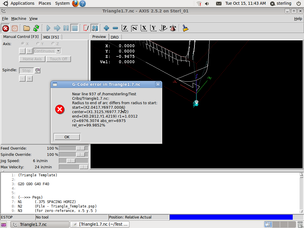

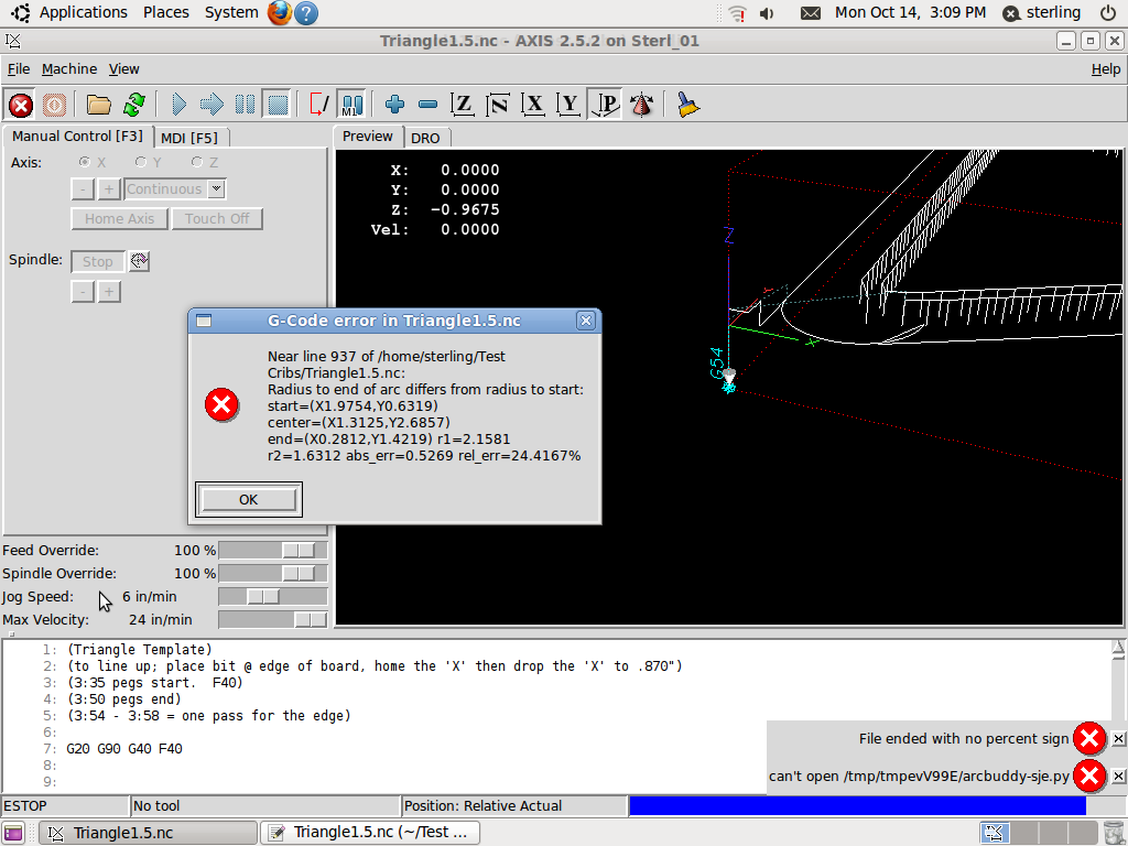

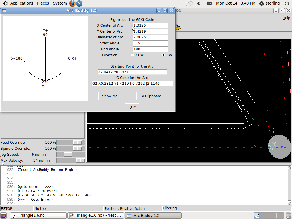

I've started using the program ArcBuddy, and it has worked fine until today (Granted I have only used it about a dozen times...)
The problem is - I enter the data (see image "ArcBuddy.png"
but when I copy it into my program (which already has two ArcBuddy outputs in it), I receive an error.
See image "error.png"
The only thing I can understand within this message is that the error file displays the 'center' coordinates incorrectly.
As you can see in the 'ArcBuddy" image, the center is =
X1.3125 Y1.4219
But in the 'Error" image, they are listed as =
X1.3125 Y 2.6857
Thanx in advance!

New development...
I re-entered the data then changed the angle from 315 to 180 'CW'
to
180 to 315 CCW.
No error was returned, and the arc did show. However, this no longer follows the path. The spindle will now travel down it's projected path, then it will have to rise up, cross over to the bottom of the triangle, drop down, cut the arc, ending at a point where it just was, then lift up again, travel back to where it just dropped down to start the arc, but follow its initial path along the Y axis, where it will reach the next Arc (etc) until it reaches this spot again...

15 Oct 2013 18:06 #39865
Replied by andypugh on topic Error in ArcBuddy
Something is wrong, clearly, because that J value has to be nonsense. (The J offset can't be more than the diameter, that makes no sense at all)
- BigJohnT
- Posts: 3981
- Thank you received: 994
15 Oct 2013 19:02 #39872
by BigJohnT
Replied by BigJohnT on topic Error in ArcBuddy
Wow I wrote that in 2008 and you just discovered an error. It calculates the arc based on the quadrant the arc lies in so one of the sections has an error. Let me see if I can find that and fix that.

15 Oct 2013 19:36 #39874
by BigJohnT
The quadrant 4 error has been fixed however the send to axis is broken and probably not very useful anyway as is only sent the G2/3 line.

15 Oct 2013 22:43 - 15 Oct 2013 22:44 #39885
by BigJohnT
The ArcBuddy now works fine. There is a feature if you open arcbuddy.py in axis the Quit button changes to Sent to Axis and Quit. The Send to Axis and Quit feature seems to be broken now. Something must have changed in Axis. The current version 1.3 will work except for this feature.
Just download the current one from the wiki.
JT
