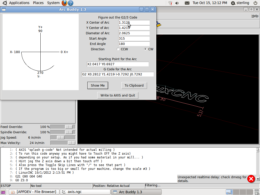

Post a screen shot of ArcBuddy with the fields filled in.
JT
JT

A typo I assume when you inserted this into your file, your start position is Y6977.0000 instead of Y0.6927

16 Oct 2013 00:20 #39896
by Sterling
Replied by Sterling on topic Error in ArcBuddy
Um...That's what populates. I don't type that in. Am I supposed to?
- BigJohnT
- Posts: 3981
- Thank you received: 994
16 Oct 2013 00:22 #39897
by BigJohnT
Replied by BigJohnT on topic Error in ArcBuddy
I don't understand what you mean by "That's what populates."
The position your in before the arc is not correct for the coordinates of the arc.
JT
JT
- Sterling
- Posts: 97
16 Oct 2013 00:28 #39898
by Sterling
To use this,
What I do is enter data into the top five (5) fields, I then select the arc direction then press the [Show me] button to display the arc.
When it does this, the program populates the [Starting Point for the Arc] and [G Code for the Arc] data.
- BigJohnT
- Posts: 3981
16 Oct 2013 00:31 #39899
by BigJohnT
Ok, I understand now.
In your G code your not at the starting point for the arc and that is why you get the error.
What is the move before the arc and the arc in your G code?
JT
JT

16 Oct 2013 01:00 #39902
by Sterling
I got it! (sort of...)
I typed everything in, and for a [Starting Point] I used =
x1.9375 y5625
When I clicked on the [Show me] button, it re[populated and changed it to the following =
x2.0417 y06977
This was giving me the error, so I thought I'd try it once it had already populated.
It worked!
I modified the arc beginning from 315 to 307.3 and I my starting point is
x1.9374 y0.6016
I can see a slight deviation at the start, but the ending lines up!! I think a bit of adjusting on the circle's "Center" might line it up perfectly!!
I'll let you know, thanx!
x1.9375 y5625
x2.0417 y06977
It worked!
x1.9374 y0.6016

16 Oct 2013 01:13 #39904
by BigJohnT
Is this
(New arcbuddy - still an error)
(G1 x2.0417 y06977)
supposed to be this?
(G1 x2.0417 y0.6977)
note the decimal point.
BTW, the N numbers don't do a thing except clutter up your G code file. If your using a post processor you can turn them off.
JT
