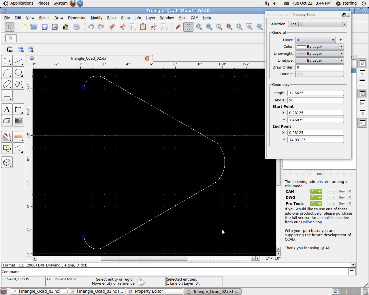

The latest version has a CAM feature that will export your drawing...however, if you have the freeware version, it will only work for the first 15 minutes the program is open. Meaning that if you need to export your design after that, yo will need to SAVE the drawing, then close Qcad, re-open it, load the image and then export it. Kinda bothersome, but my thought was it isn't a big deal if the export works well, and prevents me from hand-coding!
Yup! I have a preamble, but that didn't help.
When I actually LOOKED at the nc code that Qcam kicked out, it was giving the numbers HUGE...I had the triangle set for approx 14inches along the Y axis, and it came out over 370 inches!
Here is what Qcad gave me =
N10 G00 Z100
N20 X7.144 Y37.306
N30 Z2 F200
N40 G01 Z-2
N50 Y356.394
N60 G02 X49.212 Y377.825 I27.221 J-1.429
N70 G01 X292.1 Y238.125
N80 G02 X292.1 Y154.783 I-41.671 J-41.671
N90 G01 X49.083 Y14.288
N100 G02 X7.144 Y37.306 I-14.325 J23.616
N110 G00 Z2
N120 Z100
N130 M30
N10 G00 Z100
N20 X7.144 Y37.306
N30 Z2 F200
N40 G01 Z-2
N50 Y356.394
N110 G00 Z2
N120 Z100
N130 M30
Last edit: 23 Oct 2013 03:40 by Sterling. Reason: Insert Qcad code
- Sterling
- Posts: 97
23 Oct 2013 03:44 #40205
by Sterling
Replied by Sterling on topic Error in ArcBuddy
Here is a screen shot = You can see the Y axis measures approx 14" long...

23 Oct 2013 03:56 #40208
Put a G21 at the beginning and I reckon it will come out right.
370mm = 14.5" Allowing for tool diameter the numbers look plausible.
Replied by andypugh on topic Error in ArcBuddy
