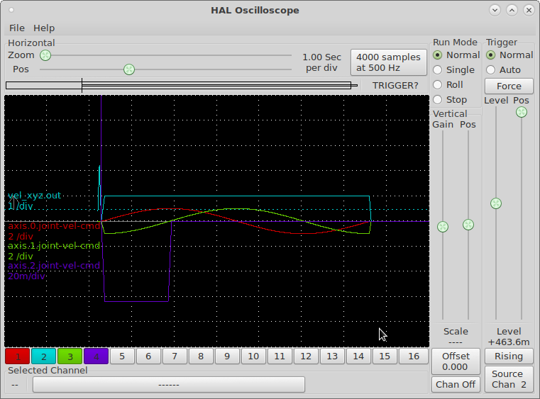

- Todd Zuercher
- Posts: 4782
- Thank you received: 1472
21 Mar 2018 15:50 #107672
Replied by Todd Zuercher on topic Axis short stop (very short) about every 15-20 sec. when cutting circle.
Here is a simplified g-code file that reproduces the bug.
New TP enabled
New TP disabled with ini setting ARC_BLEND_ENABLE = 0
New TP enabled

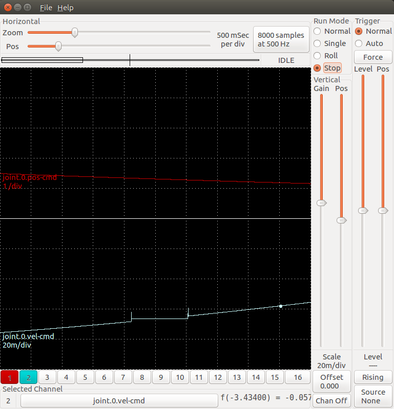

- Posts: 18087
- Thank you received: 5321
21 Mar 2018 15:54 #107674
Replied by PCW on topic Axis short stop (very short) about every 15-20 sec. when cutting circle.
is it possible that just the switch between helical and plain arcs needs to slowdown to avoid a Z axis accel limit?

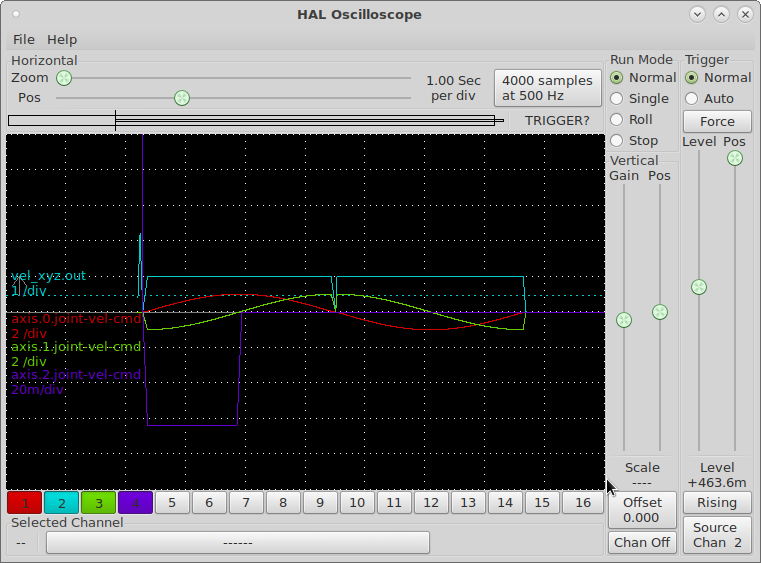

- Posts: 18087
21 Mar 2018 16:18 #107676
- Todd Zuercher
- Posts: 4782
21 Mar 2018 18:18 #107684
Those two tiny velocity blips with the old TP are not the same as the full stops showing up in the new TP. (Nor are they in the same location in the G-code.)
I can not get the repeating predictable stops with the old TP as I can with the new one. I can get small slow downs but they look more like the old line length limitation issue that lead to the creation of the new TP.
- Todd Zuercher
- Posts: 4782
21 Mar 2018 18:48 - 21 Mar 2018 18:51 #107685
Near lIne 73 (actually line 72) looks like a short line segment slow down in the old TP. (it isn't a full stop like I'm seeing in the new TP.)
Old TP around line 73 in gcode:
Not clear whether this is a TP bug or just bad gcode
