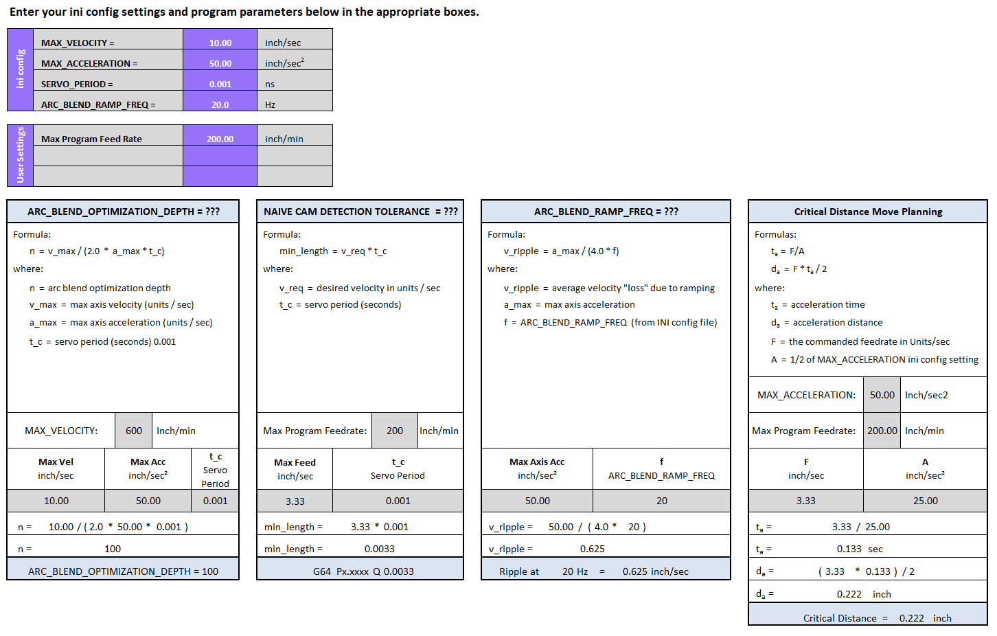

13 Jan 2023 22:50 #261835
by Lcvette
Replied by Lcvette on topic Axis short stop (very short) about every 15-20 sec. when cutting circle.
i ended up just slowing things down, but im now trying to go back in and find a resolution for this as i have some large runs to make and the slow settings are crippling. I have been putting together some easy to use spreadsheets that spit out entries for the trajectory config section from the formulas in the docs, but have a few questions on how to set them. maybe you any of you have a moment and could chime in and help me to fill in any gaps or add some additional pertinent details on how it all puzzles together and I can post this up somewhere to help others experiencing the same issues?
