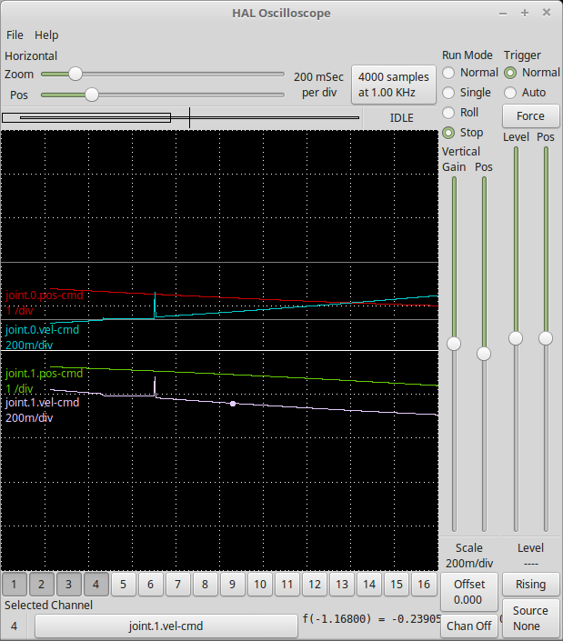

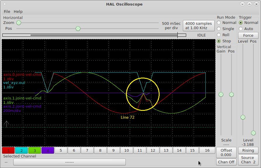

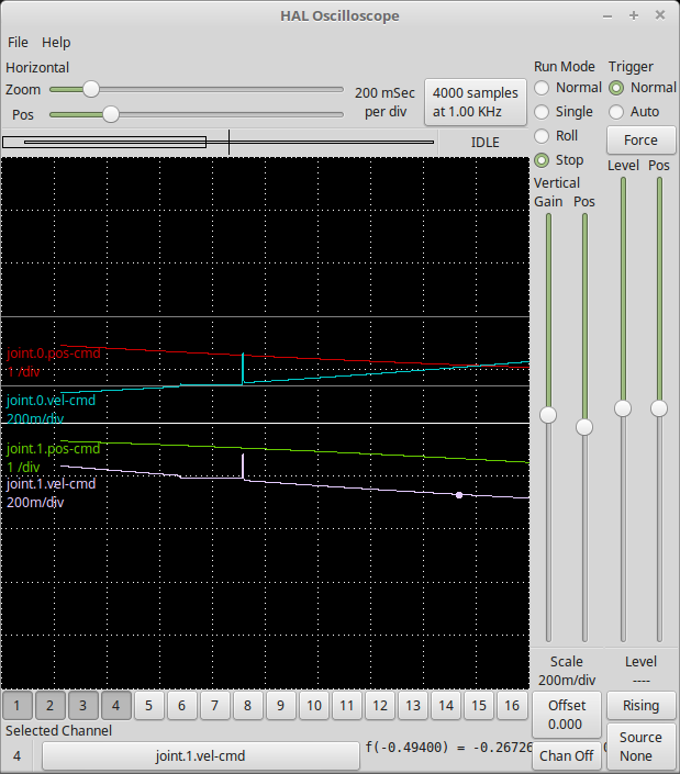

I get an identical glitch on line 72? with either old or new TPs....

Nice to see that you are trying to figure out what is causing the problem. Unfortunately i am not able to help you out with that, and today, just couple minutes before i want to do an dry test with the old TP i read your posts and didnt even start do the dry test, but i have cut my first workholding clamps from some kind of hard plastic stuff which i got from my uncle to do some tests and had no stopping at all or at least i couldnt see it.
I am not sure if that helps, but the g-code (this time 2D pocket, not contour) was is also from Fusion 360 CAM.
In attachment i uploaded the G-code.

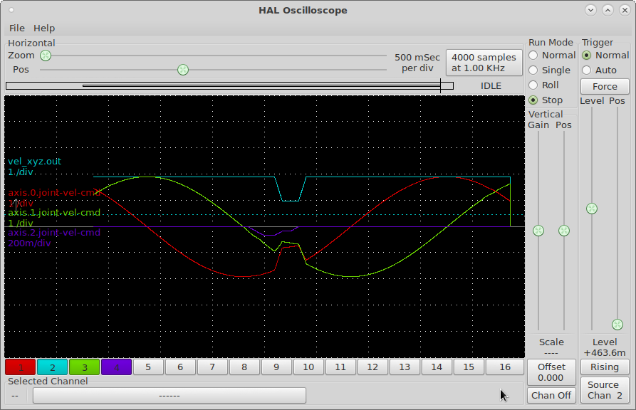

Looking at those plots I can't help but ask if you are certain you actually had the new TP disabled? (but i'd be surprised you would make a mistake that.)
I'm switching between the two modes by using "setp ini.traj_arc_blend_enable 0" or 1. It doesn't work while a g-code file is running, but it switches fine between runs.
(rather than exiting and restarting with different config settings)
- Posts: 18115
- Thank you received: 5334
21 Mar 2018 20:18 #107694
Replied by PCW on topic Axis short stop (very short) about every 15-20 sec. when cutting circle.
Yes thats exactly what am doing, and I am certain the mode is changed
( on your little test gcode I get a glitch at both velocity peaks with the old TP but only the positive peak with the new TP )

The screen shots I've made were taken using the sim.axis config that comes with Linuxcnc. What config are you using that seems to pick up these decels with arc blend disabled?
- Posts: 18115
21 Mar 2018 21:46 #107702
The last 2 plots are master. I also think my configs have pretty high accel settings (1/2G) so may mask blend failures
