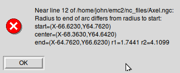

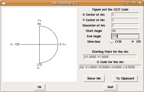

I didn't see anything in dmesg. You have to check the last position as well as the arc to see if your in the correct starting position. With Arc Buddy you can define the center and the start and end angles and it gives you the two lines needed so it helps me make sure my post is putting out the proper start position as well as the correct arc move.

Replied by andypugh on topic Re:G code is not working...
BigJohnT wrote:
You know what is odd? The arc works if you take the centre relative to the _end_ position.
Is there an option to switch the postprocessor to absolute arc centres?

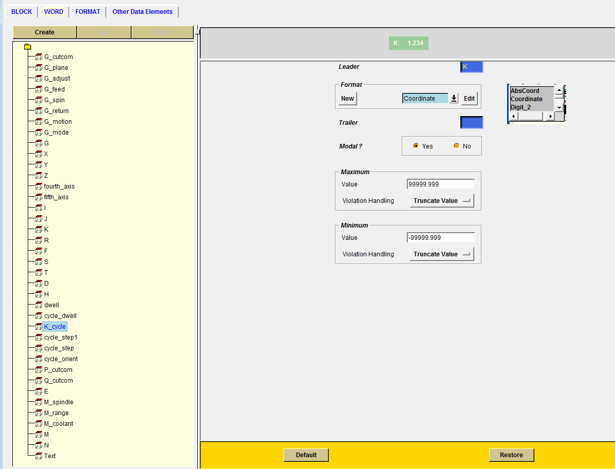

16 Nov 2010 10:57 - 16 Nov 2010 11:00 #5350
by axel88
Replied by axel88 on topic Re:G code is not working...
I think i found the option to switch the postprocessor to absolute arc centres:
But I'm not sure in wich word i have to change the format.
In K_cycle or in K itself or anywhere else?

- Posts: 19914
- Thank you received: 4662
16 Nov 2010 11:07 #5352
That looks like the wrong screen, but the I, J , K a little further up the list might be the right place.
Otherwise it will be in the G2, G3 section.
