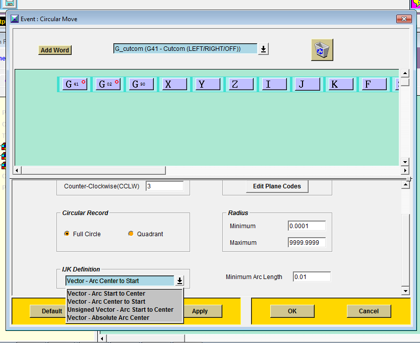

17 Nov 2010 10:26 #5369 by axel88
Replied by axel88 on topic Re:G code is not working...
Ok i think i found the option:
and in the TCL stands:
set mom_sys_cir_vector "Vector - Absolute Arc Center"
But it's still the same Error Axis. I Attatched the postprocessor files and the ngc.
Attachment tcl_and_ngc.zip not found

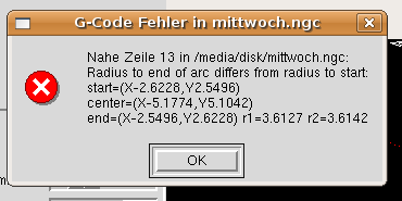

17 Nov 2010 11:32 #5372 by andypugh
Replied by andypugh on topic Re:G code is not working...
A screenshot of the exact error message would be useful. (Or just type it out exactly)
17 Nov 2010 12:49 #5374 by andypugh
I just tried your code in a VM. The radii differ by 0.0015"
I think the problem might now be one of accuracy, did you change the minimum accuracy value? It was in the box you posted the image of in #5347
17 Nov 2010 16:14 #5380 by axel88
In this postprocessor the accuracy was set as .0001 (because I have problems to load an old postprocessor I've to start a new one with all standard settings)
The Error was the same as posted here:
BigJohnT wrote:
I didn't see anything in dmesg. You have to check the last position as well as the arc to see if your in the correct starting position. With Arc Buddy you can define the center and the start and end angles and it gives you the two lines needed so it helps me make sure my post is putting out the proper start position as well as the correct arc move.
Screen Capture works.
John
but it says line 13 and the values could differ.
17 Nov 2010 18:08 #5383 by andypugh
If that is the error you saw then you have not actually loaded the .ngc file you think you have loaded. (That is an error from the old Axel.ngc, not mittwoch.ngc)
18 Nov 2010 10:01 #5408 by axel88
this is a screenshot of the error, but i ment it is the same kind of error as in the screenshot before.
18 Nov 2010 10:39 - 18 Nov 2010 10:40 #5411 by BigJohnT
Replied by BigJohnT on topic Re:G code is not working...
You are slightly out of tolerance for the arc in mm. You need to tighten up your tolerances in your post processor for circle and or offset.
You are getting real close!
John
