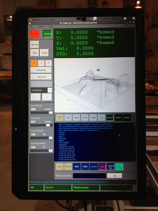

18 Jan 2012 19:30 #16914
by KPA
Replied by KPA on topic Re:Changing the openGL colors in the Axis GUI
Loboy,
Couple of quick questions.. is the middle separator bar dragable? Also it would be nice to have spindle speed on the display.
Great work!
Jay
Great work!
Jay

19 Jan 2012 01:00 #16920
by loboy
Replied by loboy on topic Re:Changing the openGL colors in the Axis GUI
Jay,
Nothing as of now is draggable. On window expansion, the right hand column expands, and the preview and gcode readout expand, as with their toolbars.
The code is now modular enough, that moving panel blocks around in the layout is simple. I prefer to keep all machine controls left justified. However, shifting the machine controls to the right is easy. This is a personal preference, and has more to do with where your monitor is situated in relation to your machine and your workflow.
I could throw spindle speed on there as well. I don't currently have digital spindle speed control on my machine. One of these days...
The monitor I have is 1440 x 900, which is 16:9 widescreen. So the overall layout is a little less than 900 pixels wide. This layout won't work on a 4:3 monitor, or a monitor with any less of a resolution. Getting Ubuntu to rotate 90 degrees was a little difficult.
Also, this layout wouldn't be right for the use of a lathe, I would think. As I don't have a lathe, I am not quite sure what the work flow preference is.
The workflow of this layout is top to bottom, instead of left to right.

05 Mar 2012 14:13 - 16 May 2013 20:16 #18401
by loboy
Here is how I implemented the DRO. I also removed the tiny digital readout from the live plotter preview.
So I have been using this interface for about a month now, and everything has been smooth as silk. An interesting quirk I found that when using the MDI, when I arrow down in the MDI command input box, the history is actually still there. So I don't need the large box containing all the history of MDI commands. Just a quirk in my code that I found is pretty handy.
I think I am going to implement an XY grid in the live plotter preview. Has anyone done this?

05 Mar 2012 15:19 #18406
by KPA
Are you thinking like the 'compass rose'? that shows the origin and axis arrows? or a full grid in all views?
Nice that you've been giving it a shakedown to test it out!
Jay
Jay

05 Mar 2012 19:27 #18416
by loboy
KPA - I want a regular grid over the XY plane, like in most CAD applications. I have written one in OpenGL before for another app, so I will probably just move some code over. I will do major grid lines every inch, and minor grid lines everything 1/16 inch, all the way out to the machine limits. I will most likely make it adjustable for different situations, and for both imperial and metric units. I like having a grid, so I have a bit more of a reference.
cncbasher - Once I neaten up the code more, and make it easy to move to another computer for testing, I will be sure to post here. Any thoughts on how to appropriately package the new Axis code is appreciated. I don't know if I should just fork the code, and call it something different...
cmorley - Thanks. Is that person on these forums? Or do know where I can find them or their work? Yes, removing that little DRO was a little cumbersome. Doing fonts in OpenGL is just not worth the work, especially how it constantly needs to redraw the tiny DRO.
