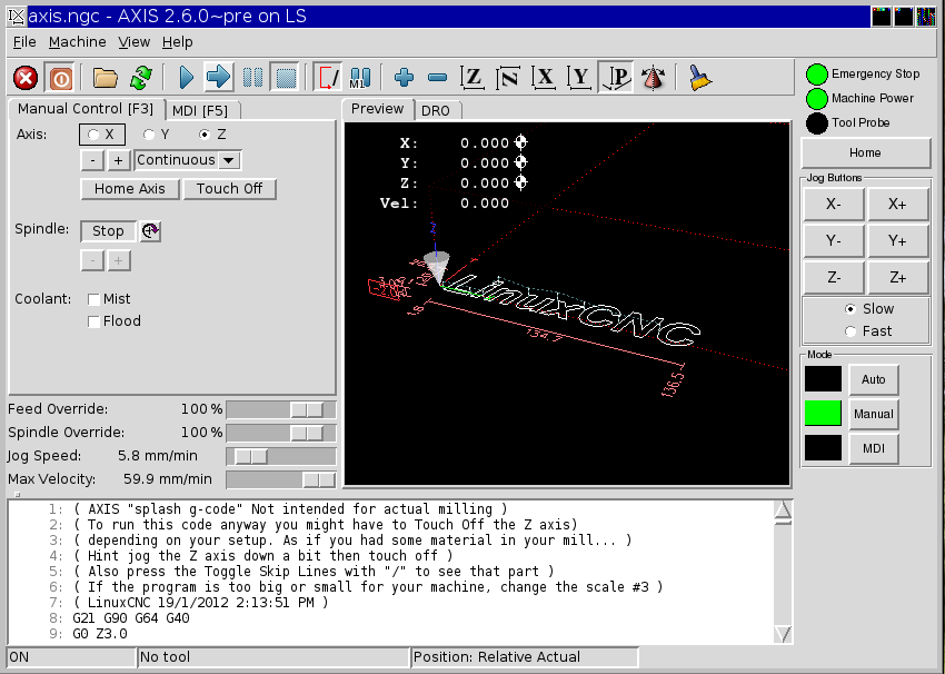

I know this is a pretty old post, but I'm having the same issues as you were Gold Boarder. Can you share your latest config files? I'm also curious to see how you setup the Auto, Manual and MDI HAL GUI. Thanks.

(User names are above the avatar, "Gold Boarder" is just a sign that he has posted a few hundred messages.)
Can you describe exactly what problems you are having?

Ha (noob), realized that shortly after posting. I'm trying to get to where @eslavko is at (see below). I'm having the issue where linuxcnc is not letting me control the machine during this process. Also, I'm wondering if I should be going back to G53 (my home position) before the tool change instead of currently just raising the Z axis. I'm not sure how to do this exactly. Should I just run N90 G53 with no other parameters? I've attached an example of my current code.
