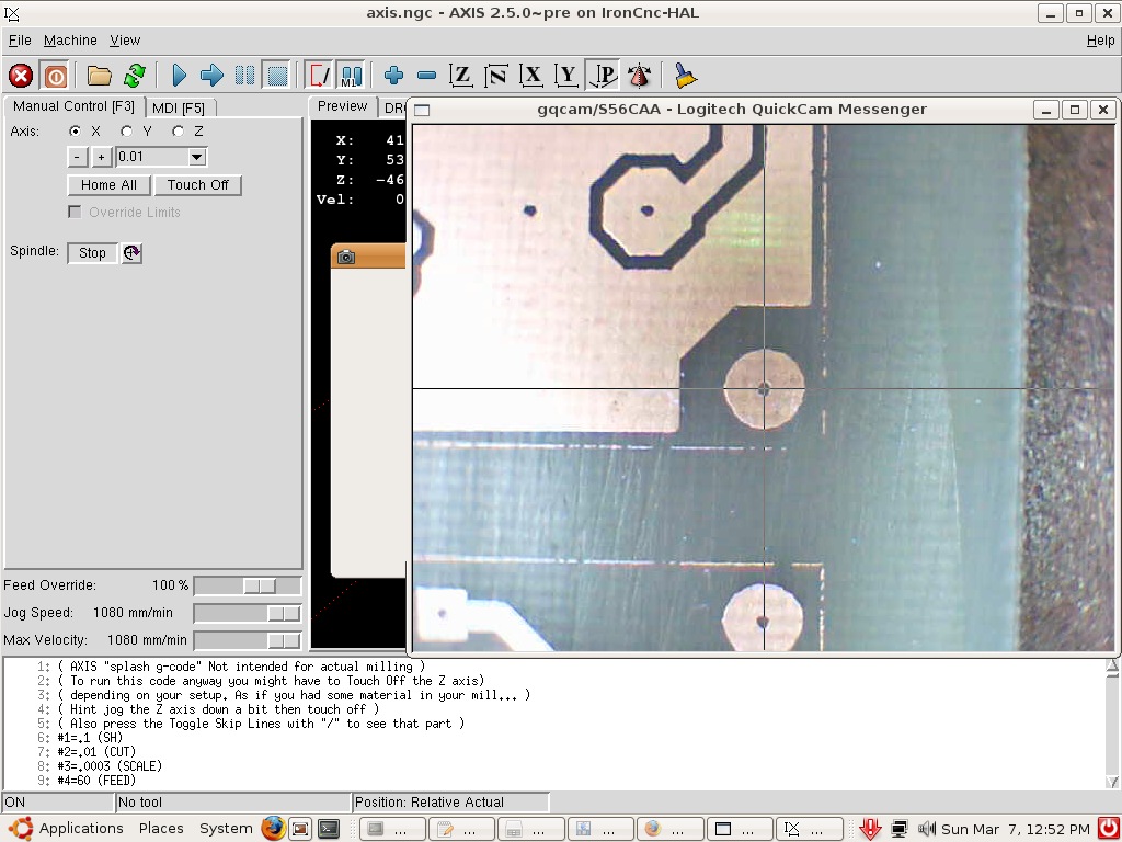

Hello...

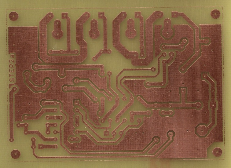

I just wonder how to align coordinate offset to drill PCB. Then I got idea to try webcam. So I just plug cheap webcam to USB port and download 1'st program for capturing video that I found. So I instal "cheese" as is already known to Ubuntu. The image I got surprise me. I'm ductaped camera onto router body and set focus to aprox 5cm (2"). The image come out perfect. I can clear see movment of 0.05mm (0.002"). I think this can be very usable for manualy find edges. Touch probe can't be used for centering on flat material. So I came on idea how to include camera view in axis alone. We already have tabs for Preview and DRO. So one more tab here to show webcam?! I'm shure that this can be done just I'm not capable to do that.

) I manage to strip out all "garbage" from gqcam. There are a lot of sliders and other thing's but I need only preview windov. So I added crosshair to image. I don't know how this can be done in python as I think the another tab for webcam can be great for aligning job. Touchprobe are great but can't be used to align some job's (PCB as example) So here is picture grabed from my computer. Of course image is not integrated inside axis! I just put program over axis. In this way it's easy to adjust job under 0.01mm tolerance. (I can easy see one halfsteep motion from my stepper 0.0075mm)
Is there realy none interested for that widget?
The hole under crosshair has 0.5mm dia (0.02")
With my experience of C language (close to 2 week experience

Looks very nice.
I don't see the benefit of integrating it into AXIS.. why doesn't it work as it is now?

Well...
When you jog machine the webcam window is on bottom (under axis window) so it's not visible.
If I got focus on webcam window to see cam then jog key's doesn't work any more.

I think the camera is more accurate. In case if you use jig from one of previous post you must 1'st set the jig in correct position and after that use as a touch probe. Camera give some magnification and job should be more accurate.
In my case I wil install camera permanently and use some offset from dril center so I don't need to remove tool at all. For driling PCB the tool height can be set with naked eye. No super accuracy nedded here.
For finding center of hole in solid block the probe will be acurate and I wil use it in such case.

that is probably true for a M$ windows.
in linux you can define the window under the mouse pointer to have focus, without bringin it to front.
It's just been disabled by default in the last couple of years to ease the transition for folks acustomed to the "windows" way.
