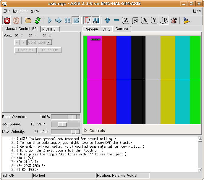

I've backported all stuff (except halio to hardy)
Here is screenshot of axis with vivi video input.

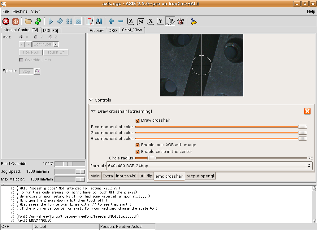

2eslavko: Check last camview-emc for convert.flip plugin which is capable for vertical and horizontal
flips.

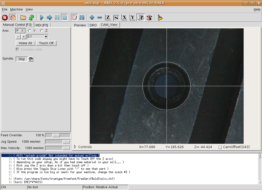

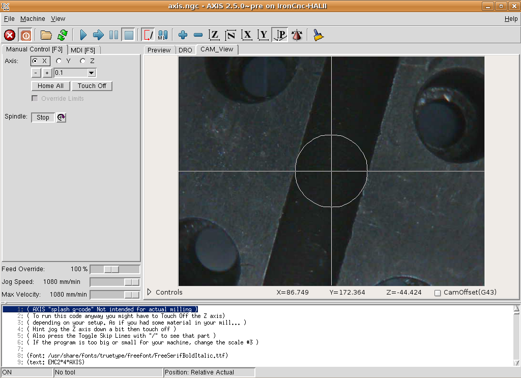

Two images to see preview.
29 Nov 2010 16:27 #5735 by eslavko
Replied by eslavko on topic Re:Another tab for WebCam
... another one
29 Nov 2010 16:41 #5736 by eslavko
... and now text...
The top image is centered in 'hole' within 0.03mm tolerance (webcam vs probe). And probe itself differ for 0.02mm in sucesive diameter reading. So cam is pretty good.
The botom image is harder to center and tolerance is more than 0.05mm.
Problems?
for both images I should use better light at 1'st place.
Centering the hole is 'easy' work to jog near center and then size circle to fit hole. The drawback is image size when 'size' slider is visible. it's such reduced...

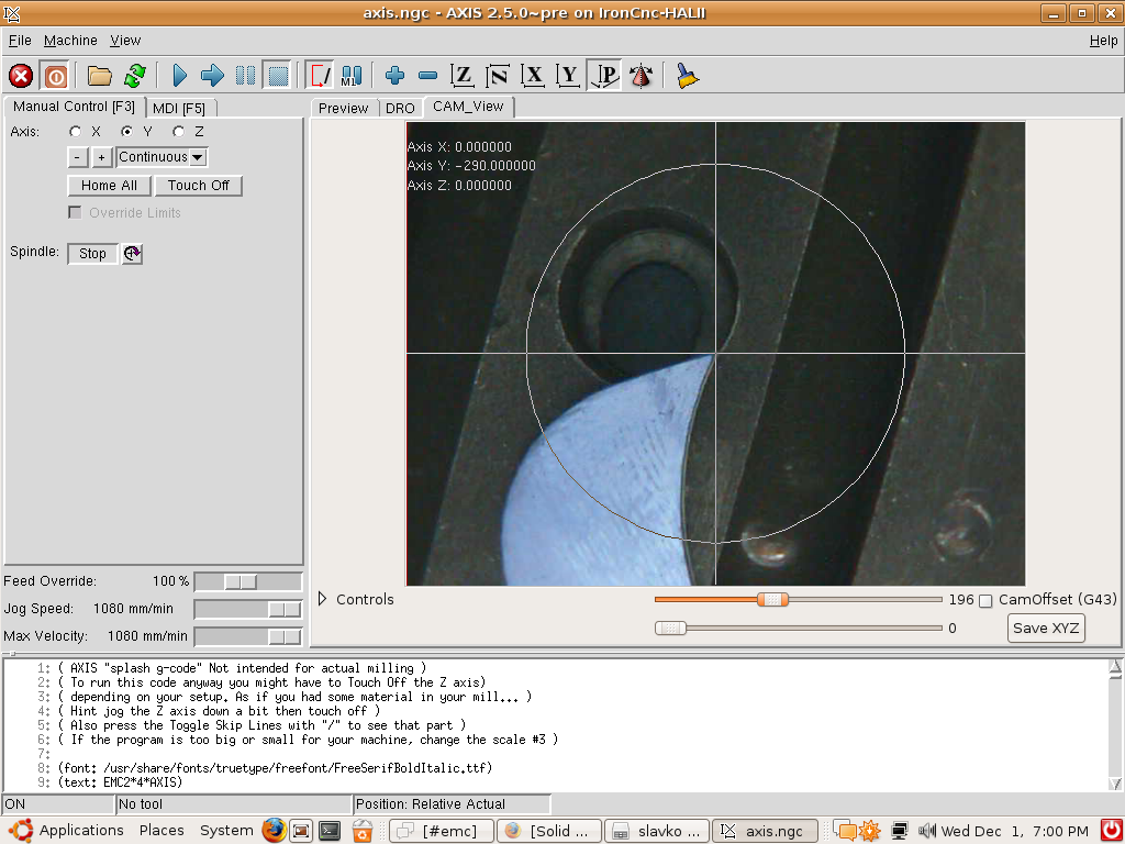

The slot centering is harder as just little arc touching the image edge.
The problem solution?!
I see solution for slot centering to have other one croshair aperture (not circle) but two lines in offset from centerline. The ofset is adjusted like 'size' for circle and there are need to other one adjuster named angle. So we can folow angle and set exact size.
Now as image is just little to small when all that widgets is oppened I think that that two sliders (size and angle) should be in panel like CamOffset is. (probably one above other where currently I have DRO) I can put here two sliders but I think the passing walue can be problematic.

01 Dec 2010 18:26 #5809 by eslavko
Here is some midversion of utility.
The CAM offset works, the Save XYZ works
Just bottom slider is not in action as circle doesn't need angle. but soon there will be lines too.
