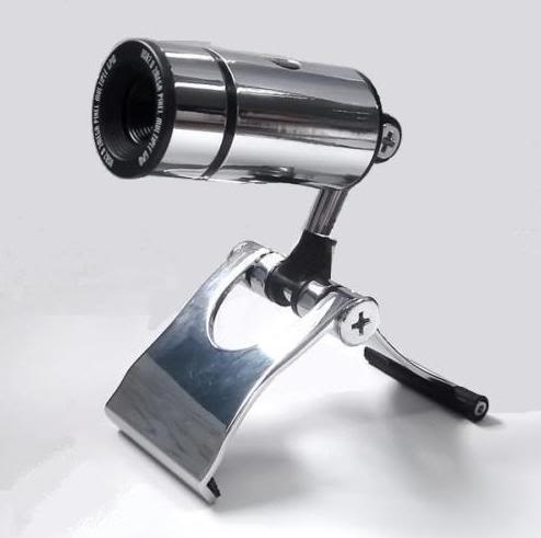

Just a quick thanks for your wiki and camview-emc.deb hosting.
I found the need for a camera centring system and this worked perfectly.
For anyone considering it, I can recommend this camera.
Sold under various names, a generic item vendor ID 1e4e in USB device info
It cost £10 with free delivery from Fleabay, works out of the box, udev creates /dev/video0 and /v4l
Best thing is its 'metal' cylindrical shell which allows easy mounting into a turned spindle mounted holder.
Therefore negligible consideration required for any parallax effect, aside from how central the lens is to its own shell, which appears pretty central.
The focussing / zoom ring can sit outside the holder mouth for ease of use with 50mm of the camera securely inside the holder.
regards

26 Oct 2011 11:09 #14279 by andypugh
Replied by andypugh on topic Re:Another tab for WebCam
That does look easier to mount than the one I have. (Which is also cylindrical and metal, but has a long, pliable, USB tail.)
What motherboard do you have, and does the camera alter the latency in any way? I have a D510 and my existing camera messes with the realtime (which is bearable, as I wouldn't machine with a camera....)

27 Oct 2011 07:38 #14319 by kostas
Replied by kostas on topic Re:Another tab for WebCam
A small tip for those about to search where to find this camera (I did), there is a nice (new?) feature on google, you just drag and drop the image above to google's images search box and google returns results based on the image search. Did that and found it on ebay.
