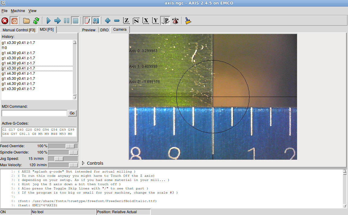

Thats really cool. Thanks for posting this and for making a wiki page.
Could one embed a gladevcp panel in axis as easily ?
gladevcp is in master branch.

cmorley
I've managed to run gladevcp panels in axis tabs (just like video on screenshot). But gladevcp needs small patch.
Please contact me on IRC, I have some questions about it.
Or if irc is not an option i'll post them here...

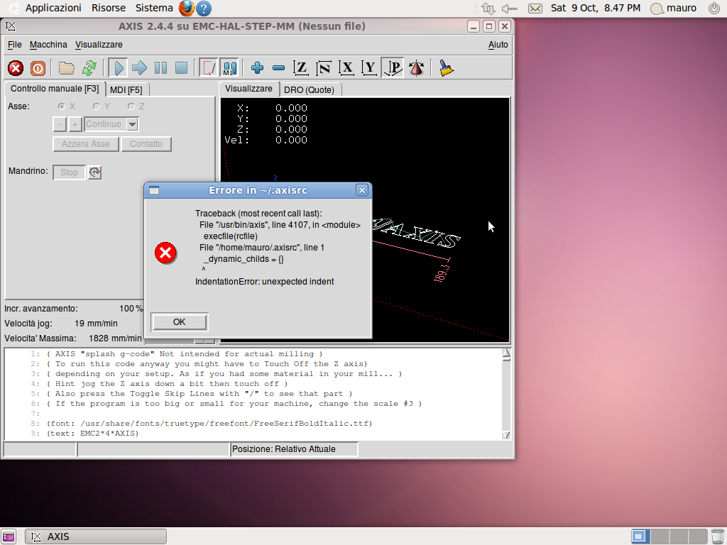

Hello everyone, I tried to install this: wiki.linuxcnc.org/emcinfo.pl?Axis_Embed_Video but I get these errors in the screen that attach ..
thanks
thanks
- Posts: 7938
- Thank you received: 2154
09 Oct 2010 22:17 #4599
Replied by cmorley on topic Re:Another tab for WebCam
Hey billykid
Thats because you cut and pasted from internet
in your file you'll see every line starts with an extra space remove them.
I ran into this problem too.
Chris M
Chris M

I've updated page with link to uploaded .axisrc code so indentation issues will go
Also there is new version of .axisrc with ability of killing child processes at exit
