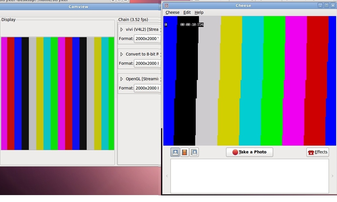

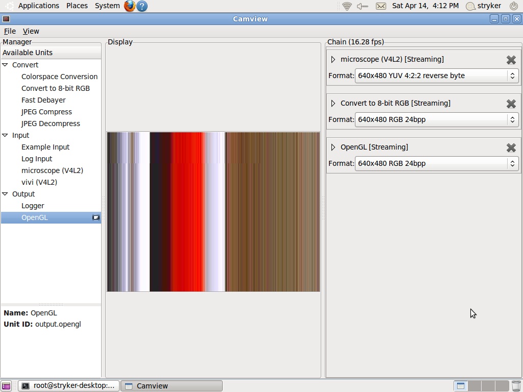

im using 10.04
yeah i saw that link, in the trouble shooting section he only mentions problems where the video stream is completely black, mine is sort-of working there is an image however it is scrambled
-edit- tried installing the vesa driver as mentioned in wiki.linuxcnc.org/cgi-bin/wiki.pl?TroubleShooting section 5.2 but it didnt work either

I tried loading the vesa drivers but didnt work.
yeah i tried loading the vivi drivers and the vivi image shows (different coloured vertical stripes sample image),however the image is different from that viewed in cheese.
when I loaded the vivi driver with cheese, the image was still with coloured vertical stripes but less stripes and a timer runniing which didn't show on camview.
also.. i tought that i installed vesa driver but in fact I had installed Installing Software-based OpenGL, i will try loading vesa drivers according to wiki.linuxcnc.org/cgi-bin/wiki.pl?TroubleShooting
cant attach screenshot dont know why

also -- i found this: groups.google.com/group/camunits/browse_...ead/81031fa36ed8d263
which seems to be exactly what my problem is, he also mentions the 2000x2000 resolution which can be seen in this picture

finally problem solved, managed to contact psha through irc and he was extremly helpful and solved my problem
the problem was that I installed camview with wget camunits.googlecode.com/files/camunits-x.y.z.tar.gz
when i should have just done apt-get install camview after adding repo as explained in wiki.linuxcnc.org/cgi-bin/wiki.pl?Axis_Embed_Video
i deleted camview files from /usr/local/lib/ and everything worked fine:)
(i still had camview installed in /user/local)
thanks again psha !!!
