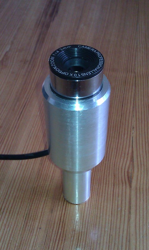

15 Nov 2011 13:24 - 19 Nov 2011 10:50 #14834 by ArcEye
Replied by ArcEye on topic Re:Another tab for WebCam
Hi
Had the camera out today, this is what the camera I recommended looks like mounted in a holder.
Holder is 36mm dia with 28mm bore for camera and a 20mm stub for mounting in a collet or collet chuck.
regards
Last edit: 19 Nov 2011 10:50 by ArcEye.
19 Nov 2011 11:04 - 19 Nov 2011 11:08 #14941 by ArcEye
Hi
Just an update to testing, if anyone is thinking of using this camera.
The focus/zoom ring is not exactly concentric to the body, this means that altering the focus to sharpen the image will move the cross hair centre.
I have roughly focussed to the distance I want to work at and then super-glued the focus ring. I can make fine adjustments to focus by moving the Z axis up and down.
This solves one problem but not all.
You will never be able to remount the camera holder exactly as previously in terms of rotation within the spindle collet. Because the focus ring is not concentric, this means there will never be repeatability between mountings.
The overall effect is that the camera is not suited in this mounting to absolute positional measurement, but is perfectly good for incremental / relative measurement or positioning.
By which I mean, you cannot mount the camera go to a reference mark on the mill bed and be at the same co-ordinates every time.
There will be small inconsistancies no matter how careful you are.
You would think that you could go to the co-ordinates for the mark and tweak the camera rotation until it lines up perfectly, but it never seems to quite work like that.
But having established a reference point and zeroed co-ordinates to it, all subsequent measurements or moves are very accurate.
I will assess how much use I actually make of the camera and if it becomes integral to my working methods, will have to consider mounting within a rectangular block fixed to the side of the head, with parallax calculations made to arrive at a true centre point.
For now my use has been in making accurate measurements of existing components to duplicate them and it works well in this role measuring from an established datum point.
regards
Last edit: 19 Nov 2011 11:08 by ArcEye.

20 Nov 2011 07:42 #14960 by ArcEye
It's a R8 spindle so I have a locating groove plus my spindle has a locking latch for tool removal.
So if I bought another R8 20mm collet and left it permanently mounted in it, that might improve matters.
The inconsistancies are not huge, but enough to prevent any confidence in accuracy.
regards

20 Nov 2011 13:17 #14964 by ArcEye
Hi
Yes it's interesting, just a pity it is windoze only.
Looking at psha's crosshairs.c in the camview-emc sources, building an alternative plug-in with adjustment capability should not be beyond the wit of man.
Might take a bit of experimentation to work out what size offset units are required, I suspect they will be very small.
First I am going to try to iron out as much as possible mechanically.
I have ordered another 20mm R8 collet and will go for a permanently mounted holder in a collet.
Between the R8 collet locating groove and the spindle lock, that should give as repeatable mounting as I am going to achieve.
I may also go for Ricks 90 degrees apart set screws, camera to holder, to give a little adjustment plus extra solidity and see where I get too.
regards
