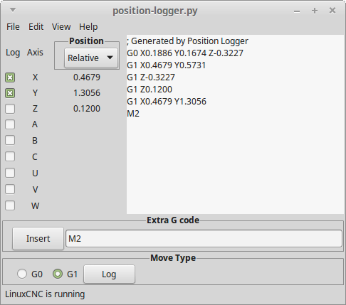

After playing around with the teach-in script I decided to expand on that thought and created a data logger with more options.
Yet to do is the menu items like Save etc. Anyway I thought I'd share this to see if I get any feedback.
To run make sure postion-logger.py is executable (right click properties) and Axis is running before you start the program.
To Download the file you must right click and select Save As
Also note that this requires GTK2 so run from a terminal the first time to check for import error of GTK.
If you get this error then install GTK2 with sudo apt-get install python-gtk2
Also note that this requires Python 2.
The latest Position Logger is at github.com/jethornton/emclog

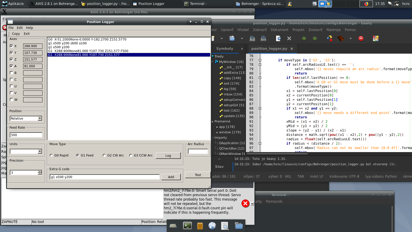

03 Jan 2021 17:32 #193967
by jurod
Replied by jurod on topic Axis Position Logger
Hi John, thanks for program.
My positions loger (from you github.com/jethornton/position-logger) makes error in row the "none" (foto)
Where is an error?
Where is an error?

05 Jan 2021 00:03 #194094
by BigJohnT
Replied by BigJohnT on topic Axis Position Logger
I don't see the error your talking about in the screen shot, can you elaborate a bit more?
JT
JT
- Posts: 22003
- Thank you received: 7488
05 Jan 2021 00:34 #194100
Replied by tommylight on topic Axis Position Logger
G1 X288.900None81.000............
there is "none" written in the axis values.
