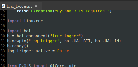

You could import the 'hal' library and create hal pins like this (example here is a digital input pin 'log-trigger'):

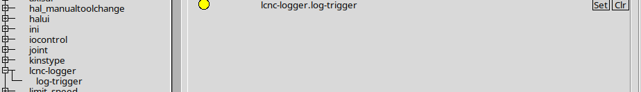

after launching linuxcnc and the logger this should show up as a hal pin:

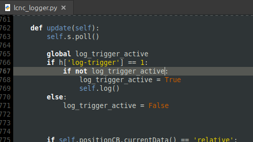

You can add the actions for these pin to the 'update' function (example triggers a log on pin 'log-trigger' changing from 0->1)
