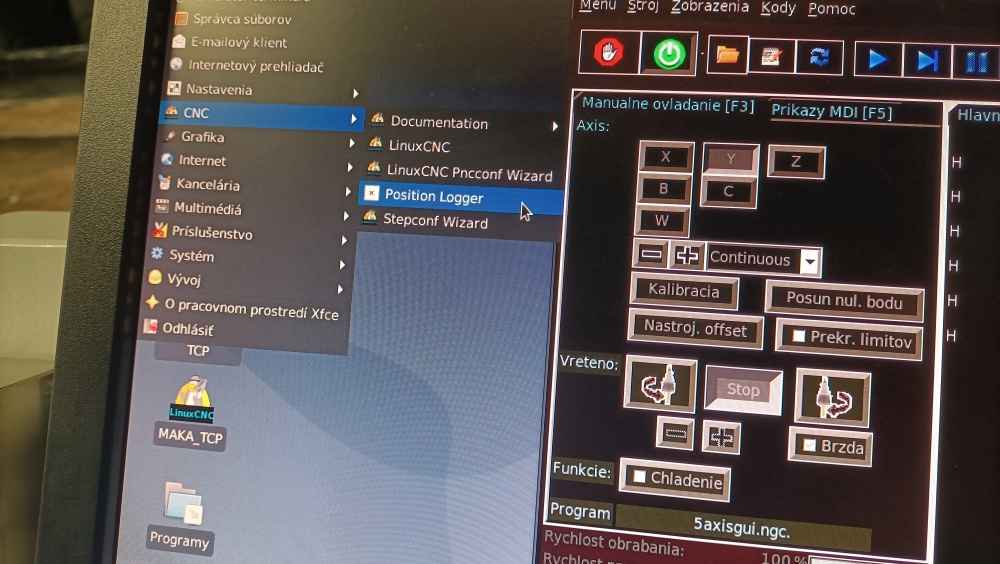

Hi, please help.
I can't install your Position Logger correctly in master version 2.9.0.
The installation process will run correctly, but unable to start Logger.
hcnc@IS7XM:~$ sudo dpkg -i /home/hcnc/emclog_1.0.0_all.deb
[sudo] heslo pre uzivatela hcnc:
(spusta sa databaza ... momentalne je nainstalovanych 100440 suborov alebo adresarov.
Preparing to unpack .../home/hcnc/emclog_1.0.0_all.deb ...
Unpacking emclog (1.0.0) over (1.0.0) ...
Nastavuje sa balík emclog (1.0.0) ...
Processing triggers for desktop-file-utils (0.23-4) ...
Processing triggers for mime-support (3.62) ...
Processing triggers for man-db (2.8.5-2) ...
hcnc@IS7XM:~$
Error from terminal:
hcnc@DELL9010:~$ emclog
File "/usr/bin/emclog", line 9, in <module>
import linuxcnc
ImportError: No module named linuxcnc
hcnc@DELL9010:~$
Last edit: 26 Apr 2022 10:12 by jurod.

You might need to also install linuxcnc-uspace-dev

I have it installed.
OK works for version 2.8.2, but switches to 2.9.0 it can't find the "linuxcnc" module.
This works correctly when switched to 2.8.2 again without any reinstallation of Position Logger.
In version 2.9.0 it still looks for some !linuxcnc! module.
Is it called something else in the 2.9.0?
From emclog.py:
From emclog.py:
#! /usr/bin/python
import os, sys, math

or it has something to do with python2.7 and python3

I've been working on it for a week. Does anyone know why it can't find the linuxcnc module?
