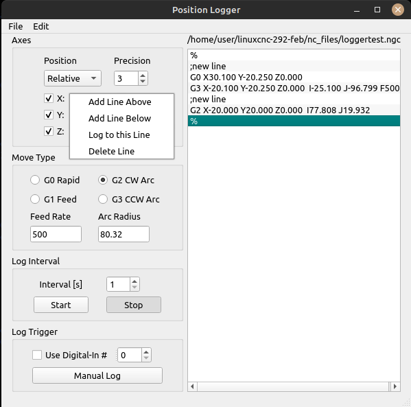

Here is my last version.
I removed everything I could not get working and added a bit more functionality to the context menu (right click in the gCode list)
[edit]
Update:
- Shows now the current file path above the GCode window
- Creates the Axes CheckBoxes and PositionLabels dynamically from the active axes information
- Fixed the Arc move functionality
Note: Still untested on a deb install.
[edit]
Update:

Also, added line editing by double clicking on it.

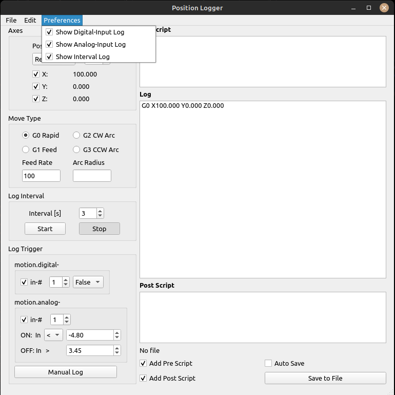

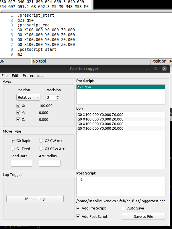

Update:
- line content is now draggable
- colored indication for invalid or missing entries
- optional pre-/postscripts
- settings saved on exit and loaded on startup
- optional auto save on log event
Update2:
- Logging with analog input
- Show/Hide logging modes through the Preferences Menu
Update2:

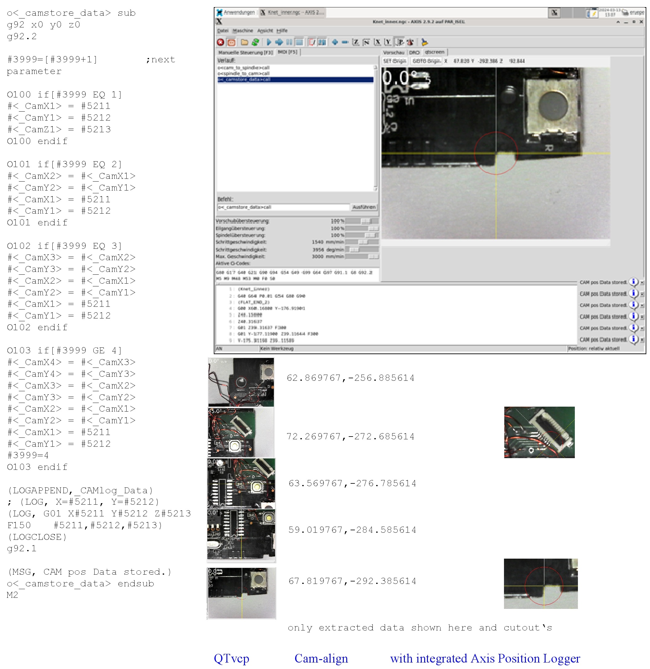

13 Mar 2024 13:57 #295823
by partec
Replied by partec on topic Axis Position Logger
shortly before was the moment for me to try out the current LinuxCNC_2.9.2-amd64.hybrid.iso
I have already noticed great progress on some important parts that I like to use, thank you very much to everyone who made it!
I think the idea with the Axis Position Logger is great, saving the file didn't work for me yet?
I would like a combined solution with qtvcp cam-align!
- Posts: 4819
- Thank you received: 2168
13 Mar 2024 15:25 #295827
Replied by Aciera on topic Axis Position Logger
The following user(s) said Thank You: partec
