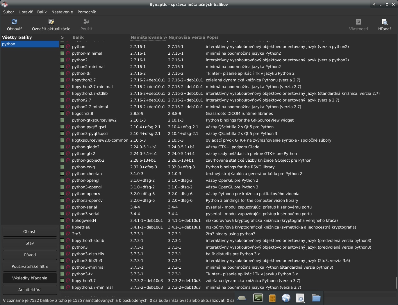

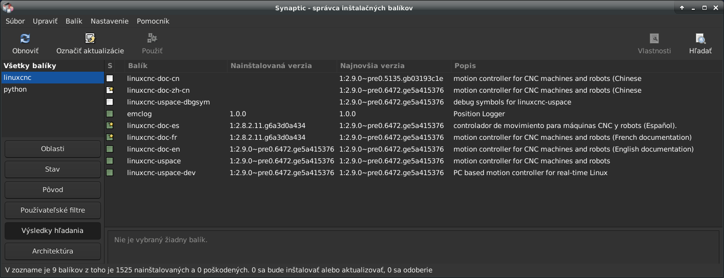

Do you have Python3 installed? 2.9 / master is 100% Python3 now.
How are you switching versions? Are you reinstalling linuxcnc-uspace-dev after switching?
Replied by andypugh on topic Axis Position Logger
I don't really know. It is almost certainly related to Python2 / Python3I've been working on it for a week. Does anyone know why it can't find the linuxcnc module?

I switch versions by reinstalling linuxcnc-uspace-dev. I have Python3 and Python2.7 installed.
13 May 2022 23:58 #242921
Switching linuxcnc-uspace-dev should come after switching LinuxCNC versions, I think.

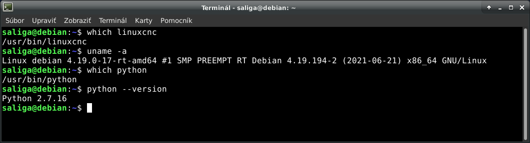

I have python installed:
(screenshot python.png)
(screenshot linuxcnc.png)
(screenshot Uname-a.png)

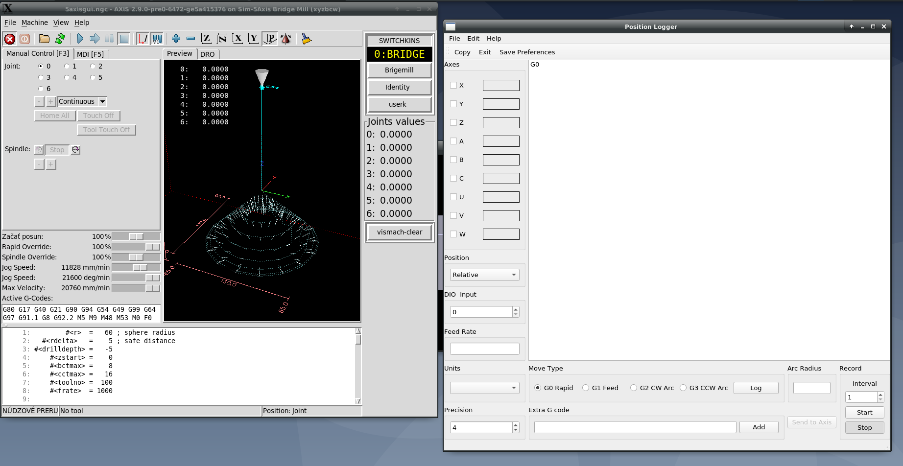

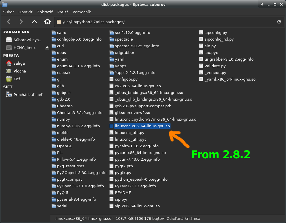

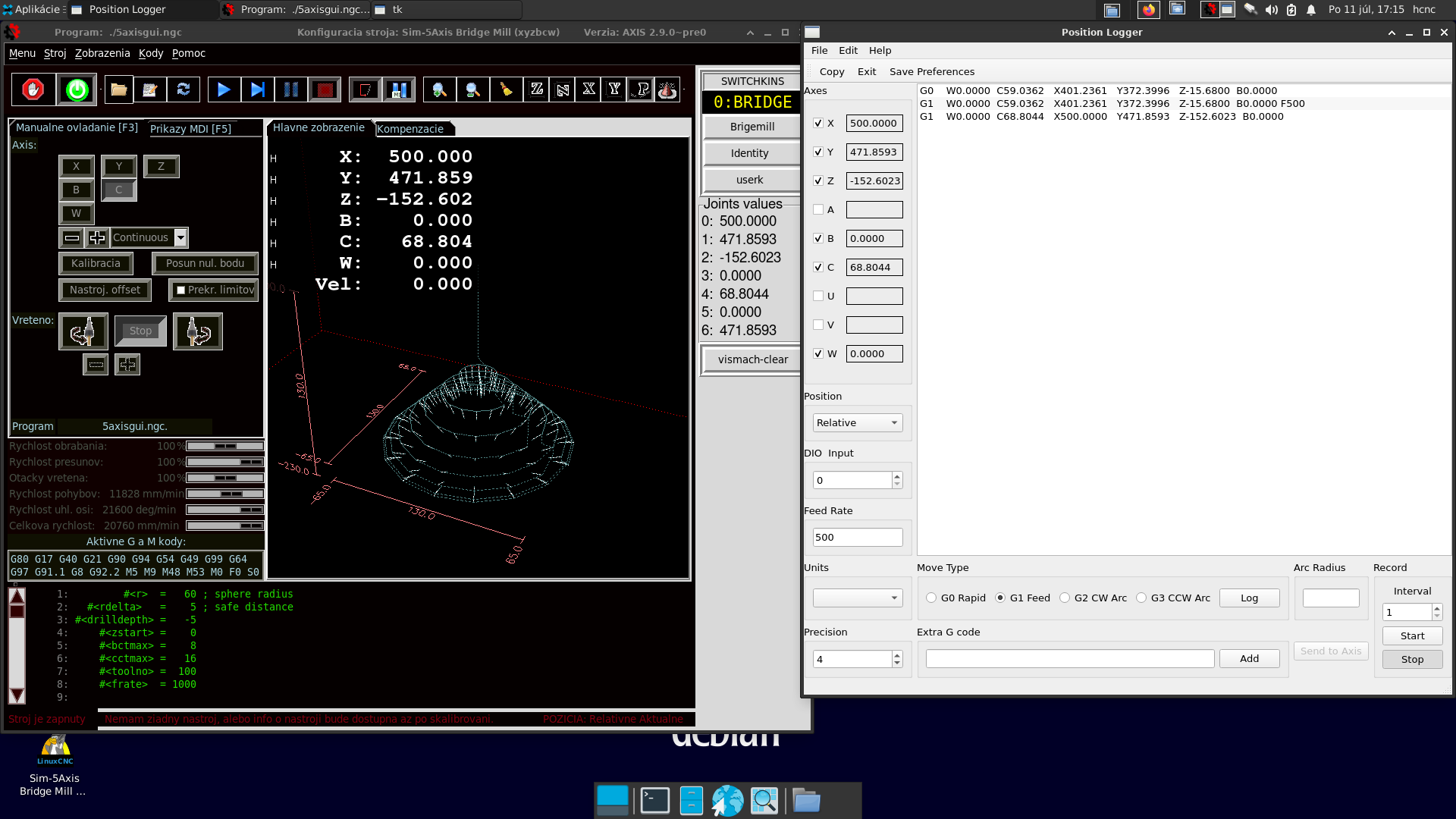

If I copy file "linuxcnc.x86_64-linux-gnu.so" from version 2.8.2 to folder "/usr/lib/python2.7/dist-packages" in version 2.9.0, the GUI will run from the Position Logger, but without a link to Linuxcnc hal.
(screenshot Pos Log.png)

Used folders:
(screenshot path to files.png)

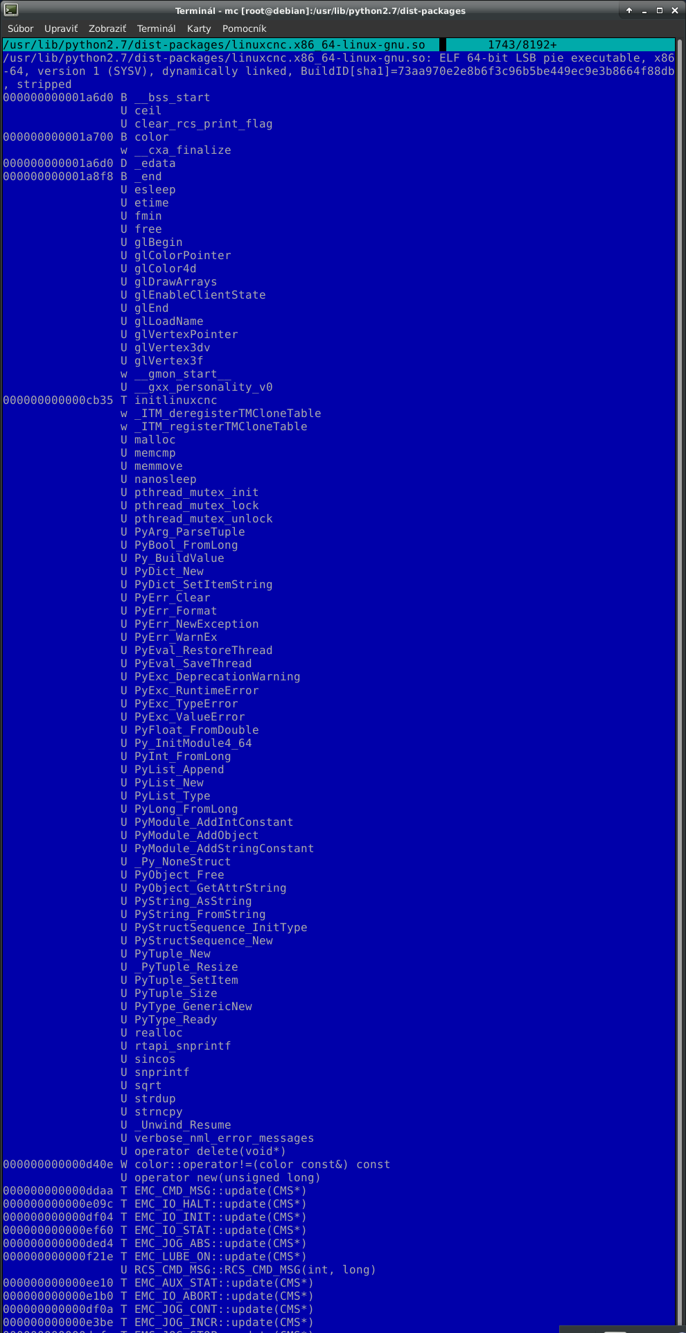

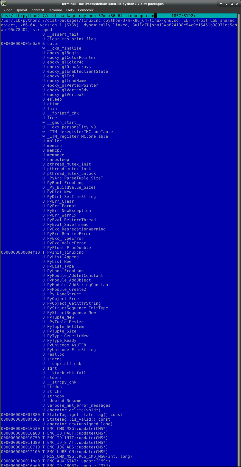

Insight to file .so in 2.8.2:
(screenshot From 2_8_2.png)
Insight to file .so in 2.9.0:
(screenshot From 2_9_0.png)

small success
I changed the emclog.py interpreter
was: #! /usr/bin/python
is: #!/usr/bin/python3
next
was: if sys.version_info[0] > 2:
raise Exception("Python 2 is required.")
is: if sys.version_info[0] > 3:
raise Exception("Python3 is required.")
etc...

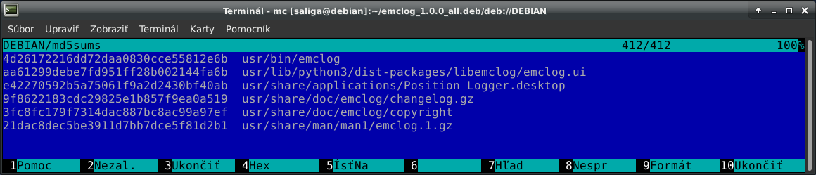

I created a file for future .deb package creation
I added "md5sums" to the file:
1a14c073dc90e29563d3b1c7cfa3b10b usr/lib/python3/dist-packages/ConfigParser.py
to my future .deb package "usr/lib/python3/dist-packages/" file ConfigParser.py (I copied from /usr/lib/python2.7 + definitely adjustments)
I changed in the "control" file:
Installed-Size: 56
Depends: python3
Section: base
and in file "Position Logger.desktop" :
Icon=/usr/share/linuxcnc/linuxcncicon.png
and I created new .deb packages "emclog_1.0.0_all.deb"
I tested on LinuxCNC Bookworm.
