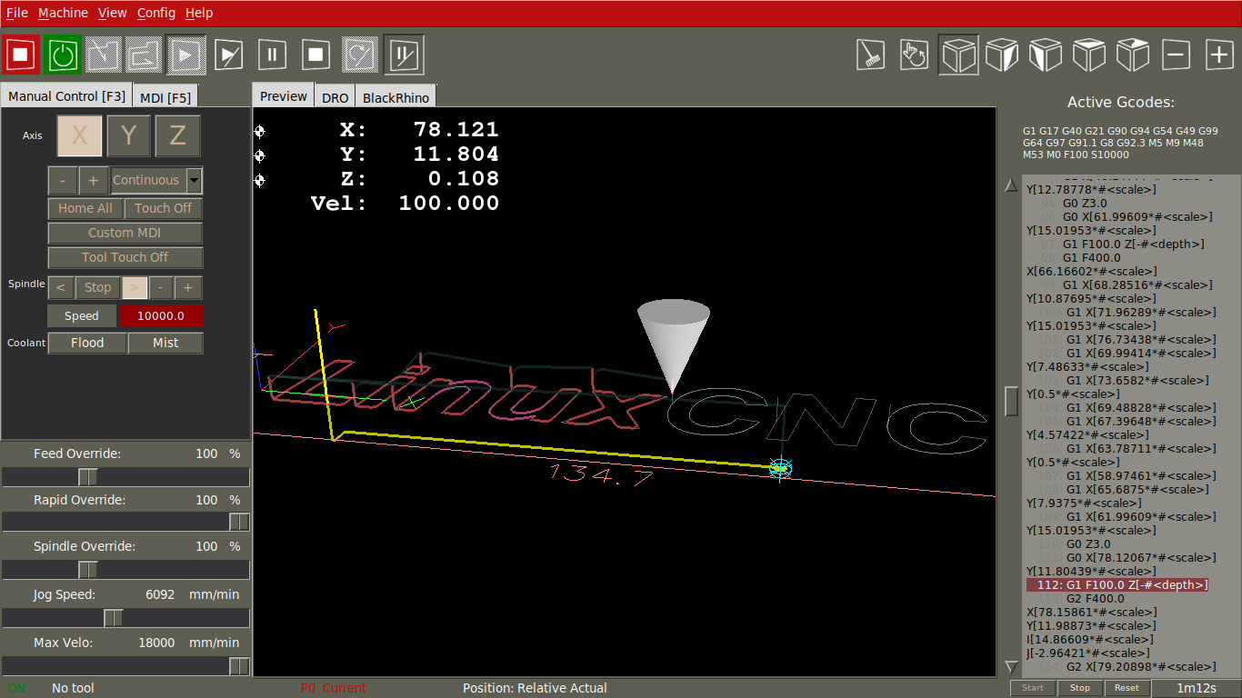

Updated to scale with some high resolution monitors

unzip code.zipmust change "display= axis2" in your .ini fileaxis2.tcl must be put in usr/share/axis/tcl - folder with elevated privsaxis2.py in usr/bin - also with root user privledgethe images in the icons folder go in user/share/axis/images - again with privscntr-q to quitcntr-g hides gcodethere is a new menu item that user can configure custom color and a custom mdi buttonthe spindle speed under spindle works with spindle-0and one can short click spindle or - for minor increments or hold for rampinga few bug fixes but please test and report any issuesNB there is a timer bottom right of screen auto activated when running a fileI have some long engraving jobs in 3d that can run from a few mins to hoursand dont stand by the machine, so always wondered how long they actually took

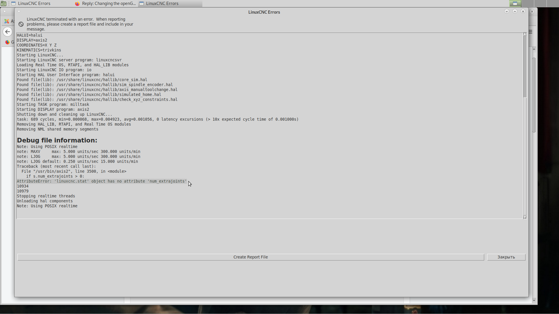

Linuxcnc 2.8.2. Start axis with your changes received an error. Please tell me how to fix this? Thanks!

18 Sep 2021 16:37 - 19 Sep 2021 04:14 #221023
by cakeslob
thats the main problem imo with working with axis.tcl/axis.py instead of the usercommand file, his version is from several updates ago. compare the current version of of axis.py/tcl to the axis2 version, I found it easier to apply the changes to the current version of axis.py instead of updating axis2.py
edit, shit that was the older one , i have try out this newer one, looks good with the spindle
