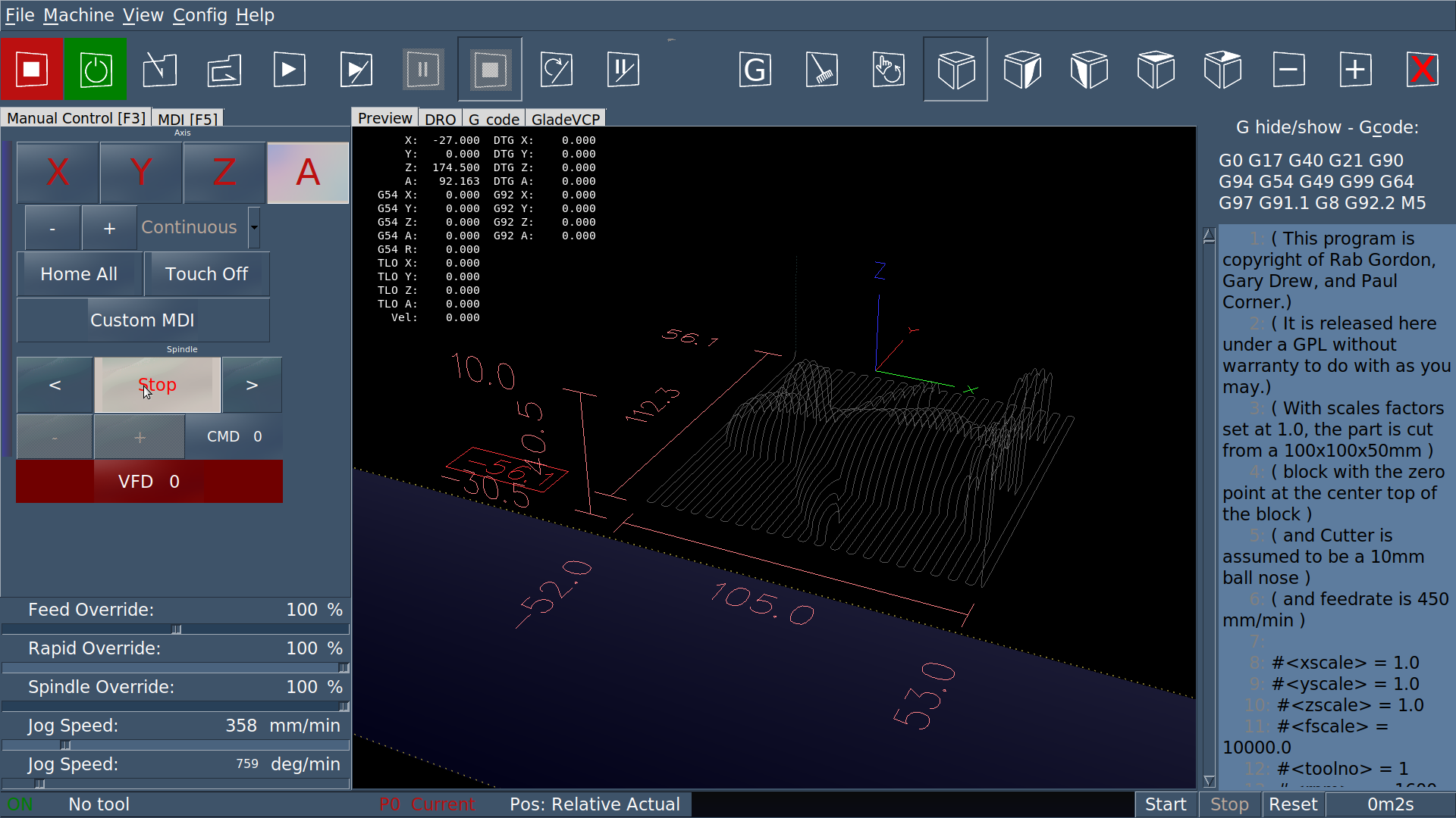

Tkank you Zack i will load this new on and let you know
- Masiwood123
- Posts: 423
- Thank you received: 93
23 Oct 2022 06:06 #254847
by Masiwood123
Replied by Masiwood123 on topic Axis 2 - touchscreen version of old friend
wow this looks very nice, just the way I had it in my head, thank you very much I can't wait to try it

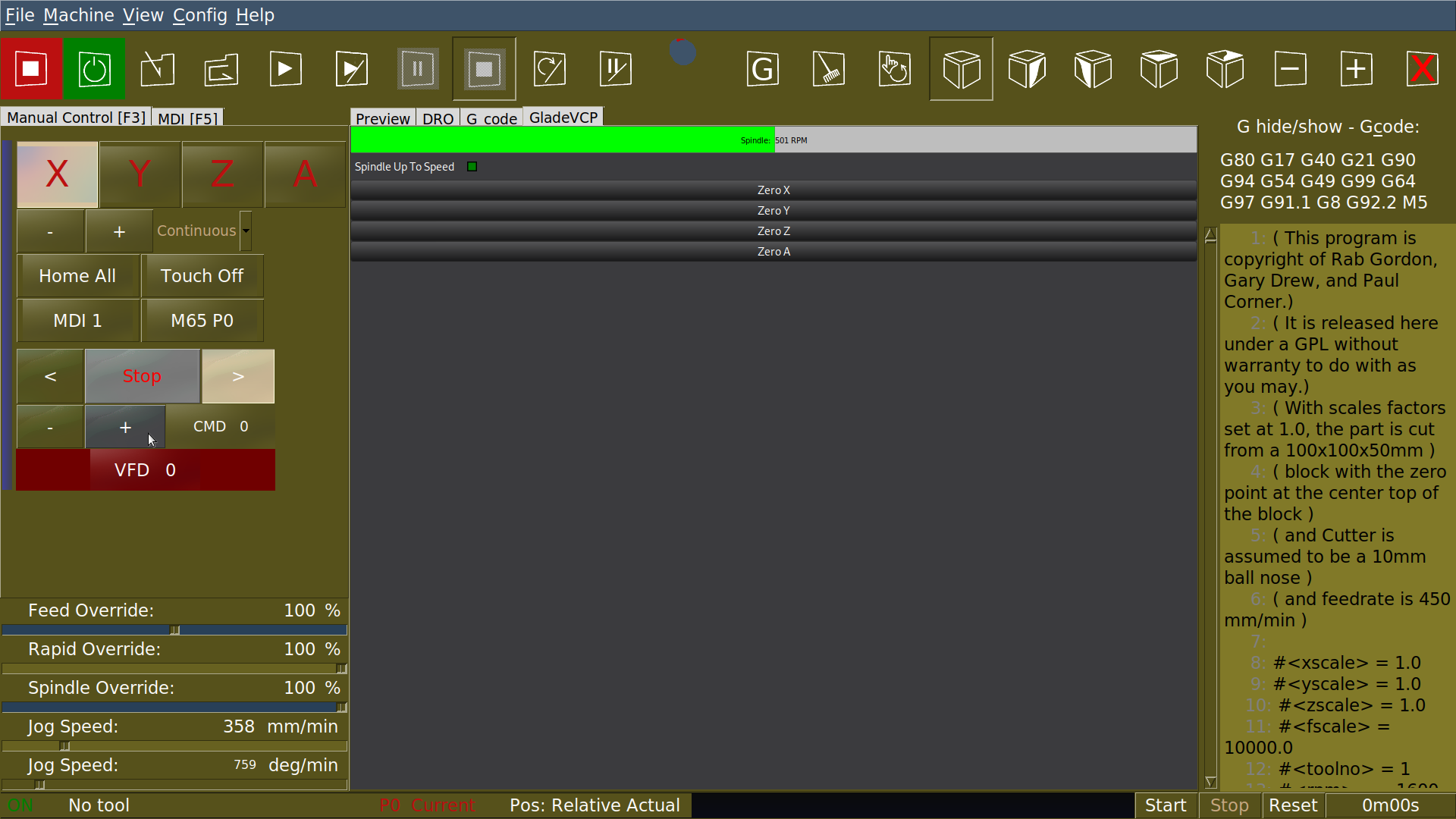

that is it ,everything works except vfd spindle speed reading rpm, it stays at zero. I tried to insert a custom pyvcp spindle panel, but then it gives me an error that the ``spindle-speed'' line is duplicated. I would like to ask for one more if it is not difficult, is it possible to add another custom MDI because I need another control (m65 p0) independent that will turn off the relay for changing the mode between A and S (for me, the axis and spindle work with the same driver and I often change his mode) thank you

Please send another screenshot, try change the color please.Your file attached.

- zack
- Posts: 91
- Thank you received: 47
24 Oct 2022 07:10 #254899
by zack
Replied by zack on topic Axis 2 - touchscreen version of old friend
ok post your hal files etc
the spindle could be configured to a different pin or it may be spindle 2/3 or so on
i need to see your ini and hal files along with glade panel if possible.

thanks Zack, here I have attached the files
- zack
- Posts: 91
24 Oct 2022 08:40 - 24 Oct 2022 09:45 #254909
by zack
Try this please - attached below
