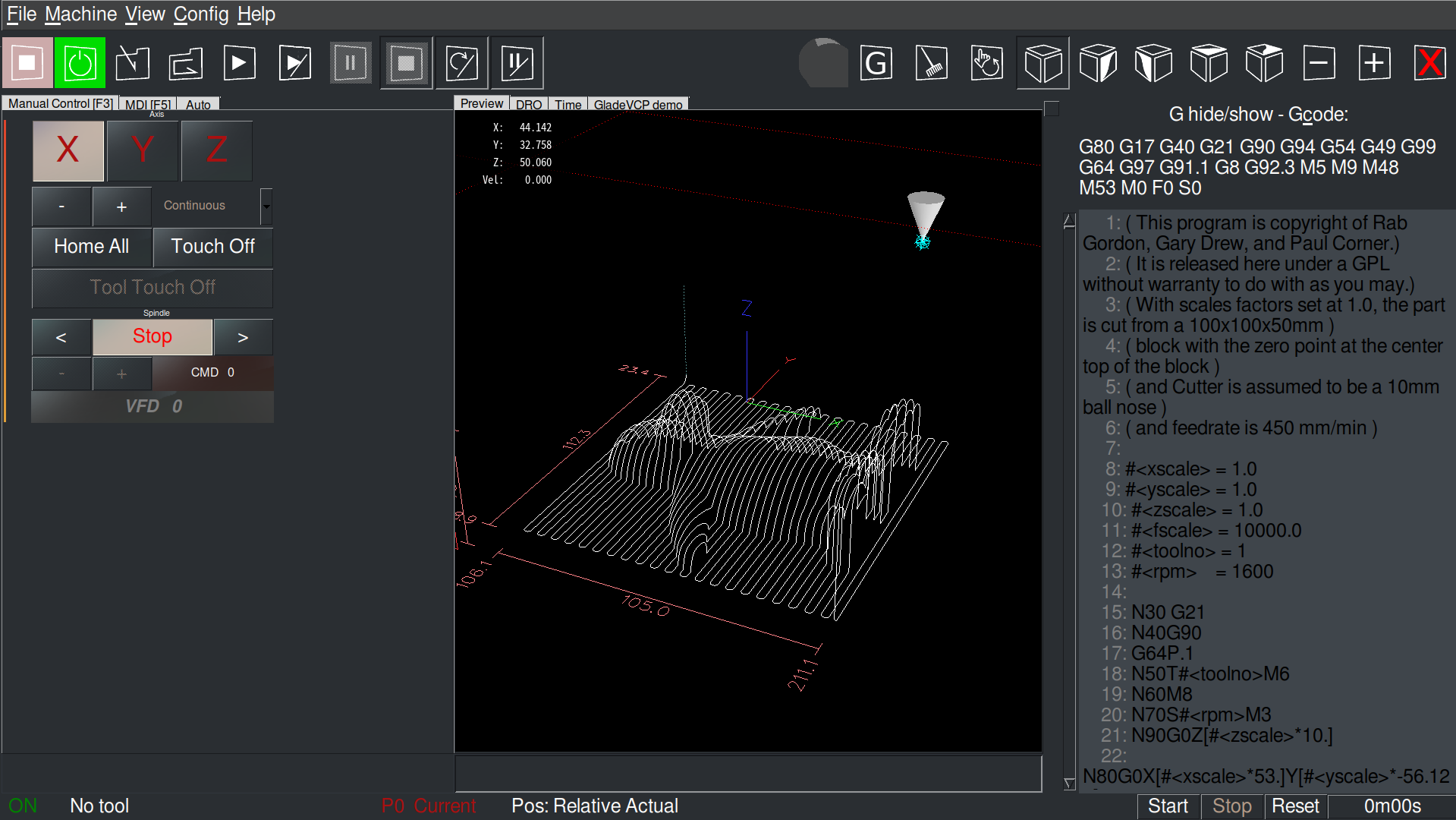

I tested this on Linuxcnc 2.10pre and works great !
Maybe add a readme.txt in zip with instructions to install ??
where "donno" should be your username
Setup Instructions Main
set display = axis2 in your ini
sudo cp -a /home/donno/Downloads/axis2/icons/. /usr/share/axis/images
sudo cp /home/donno/Downloads/axis2/axis2.tcl /usr/share/axis/tcl
sudo chmod +x /home/donno/Downloads/axis2/axis2.tcl
sudo cp /home/donno/Downloads/axis2/axis2 /usr/bin
sudo chmod +x /usr/bin/axis2
sudo cp /home/donno/Downloads/axis2/glcanon.py /usr/lib/python3/dist-packages/rs274/
sudo chmod +x /usr/lib/python3/dist-packages/rs274/glcanon.py
Linuxcnc-DEV
sudo cp -a /home/donno/Downloads/axis2/icons/. /home/donno/linuxcnc-dev/share/axis/images/
sudo cp /home/donno/Downloads/axis2/axis2.tcl /home/donno/linuxcnc-dev/share/axis/tcl/axis2.tcl
sudo chmod +x /home/donno/linuxcnc-dev/share/axis/tcl/axis2.tcl
sudo chmod +x /usr/lib/python3/dist-packages/rs274/glcanon.pywhere "donno" should be your username

Hello,
i think there is an error and think it must be:
sudo chmod +x /usr/share/axis/tcl/axis2.tcl instead of sudo chmod +x /home/donno/Downloads/axis2/axis2.tcl
(third line with sudo)
