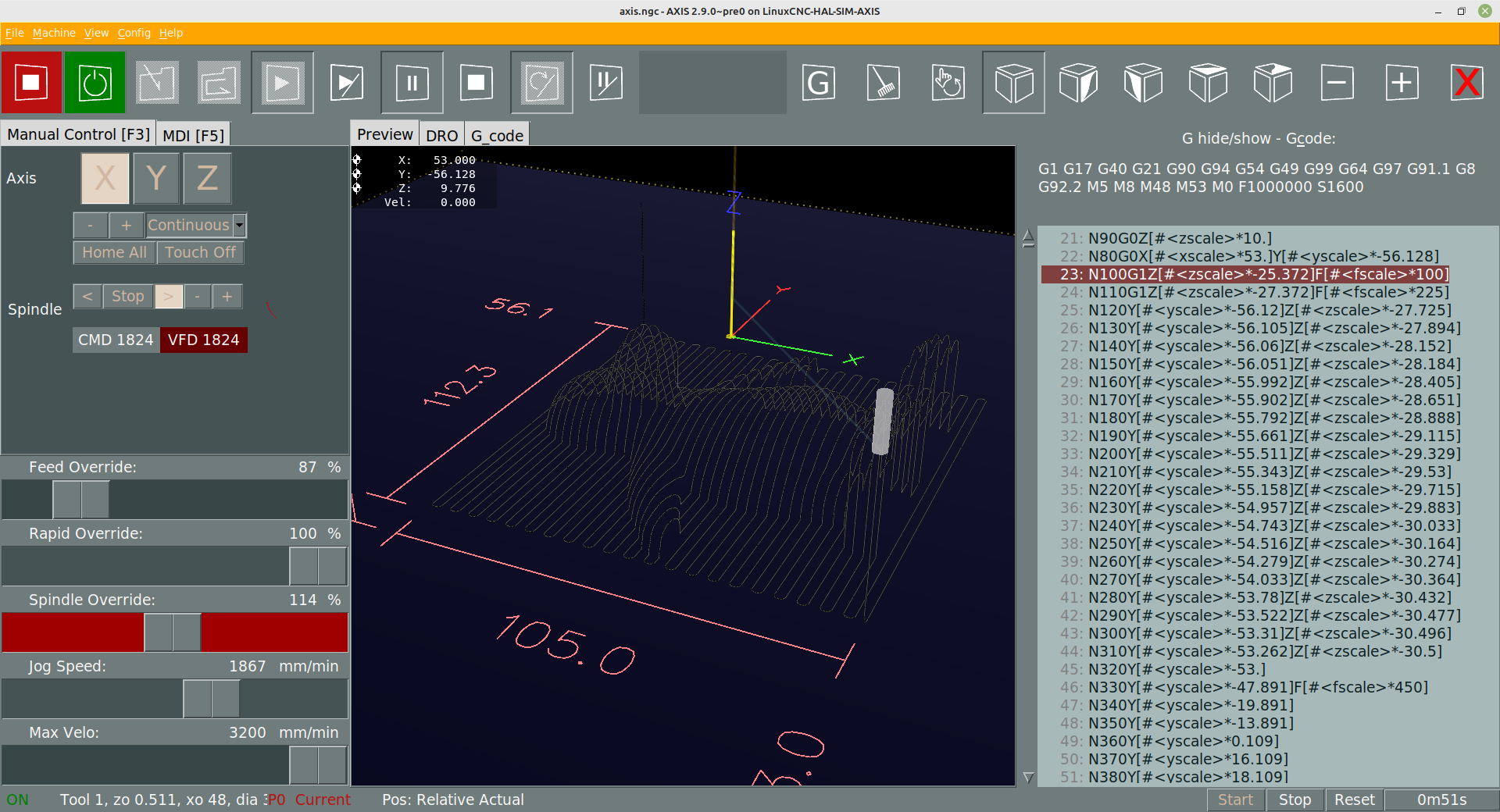

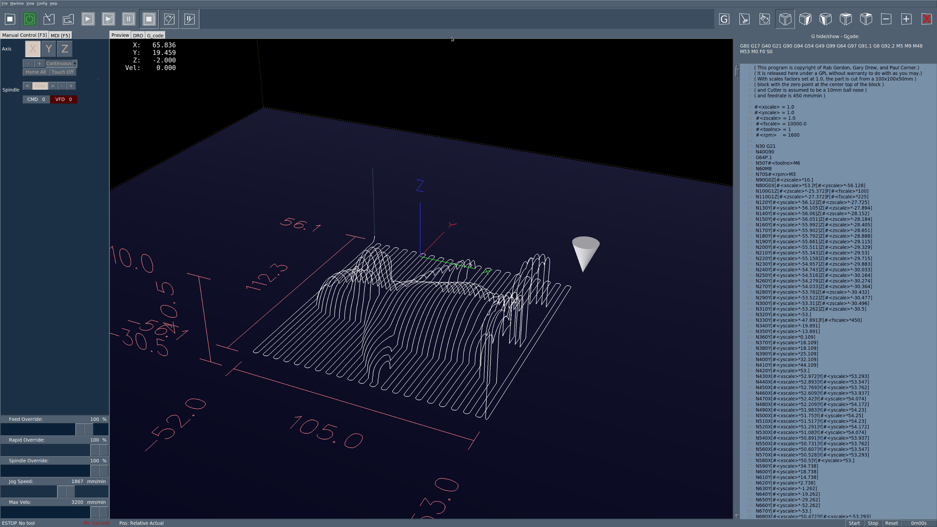

Updated for 2.9 with auto scaling for small 800x480 screens to 2k monitors.
Tommy - can you test on one of your super res monitors please?
keypress G or g - swipes the gcode pane
Space bar will auto power and home - be careful if u try on a live-machine
There is a custom menu for colors etc - give it a try please, its been stable for me on a few machines for the last 2 years, however have modded a few scaling features recently and update to 2.9 pre
set display = axis2 in your ini

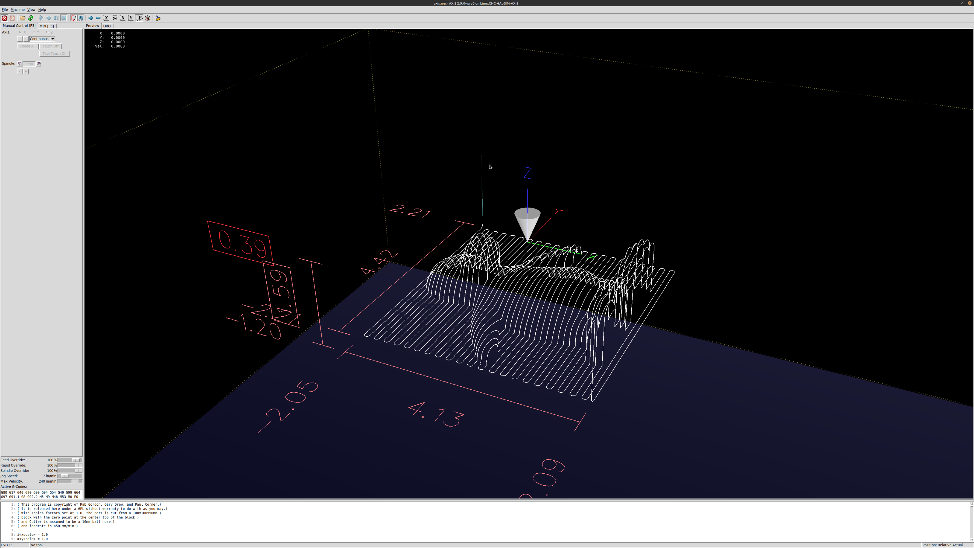

I will have to do a larger scaling version for uhd and up,
Although I have never seen a touchscreen with more than full hd.
I do suspect some new tablets will be 2k soon and would be nice to run a small machine on a 10" touch screen with a pi
I am getting into Python suggested by cakeslob, maybe a good idea to do a configurator for axis to set menu size fonts and sliders Etc
Just for interest sake what dose axis look like at 4k, is it usable?
