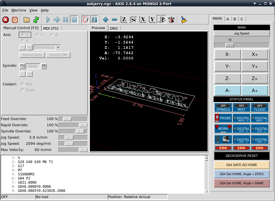

27 Aug 2015 12:54 - 27 Aug 2015 12:55 #61828
by Askjerry
Replied by Askjerry on topic MONSTER - A learning experience... pyVCP machine
Huge updates on the way...
I'm doing a bit of rewire to add a Stainsmart breakout board... two actually... I'm also adding another parallel port for added functionality.
I did want to show off the partially completed control panel however... I'm getting pretty good at this... probably going overboard... but I'm having fun.
"MONGO" is the name of my development machine (PC in my office)... once completed, I'll install in MONSTER and start testing.
Jerry
Jerry
