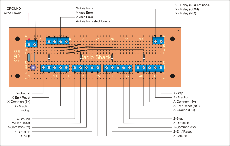

Since I am doing a complete rewire of the mill... and a totally new design on the panel... I thought I may as well do it properly.
I am taking the ERR signals from the Geckodrives and routing them to the parallel port #2 inputs. And, since there is a spare relay on the second StainSmart board... I am going to use it to RESET the Geckodrives as needed if/when there is an error. I created a board built on a Radio Shack 276-170 board where I can connect my signals and intercept the ERR signals. This should make for a cleaner install.
And... since I'm documenting this for anyone else following in my footsteps... I thought I would do it right. Eventually, I'll get all this into a PDF or something... but for now... I wanted to show it off. I am really going overboard on the documentation... a far cry from scribbles on a sheet of paper as I have done in the past.
later I'll draw up the other side, or make a schematic... not sure... but I'll document it properly.

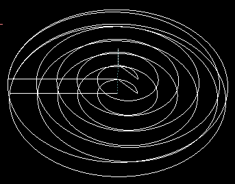

I have used ngcGUI for my tabs - I think your tabs in PyVCP are much tidier!
This is the format I have usedfiles attached below.
Looked at your halfile & had to alter the parport address for the second port... then I had to find the E-stop hardpin because F1 didn't play nice at all!! Quite a functional setup indeed. Well done & look forward to seeing your continuing progress.
By the way, what program did you use to create your graphic icons?

NGCGUI_SUBFILE = spiralpocket.ngc
NGCGUI_SUBFILE = helix.ngc
NGCGUI_SUBFILE = ""
TTT = truetype-tracer
;###############################################################################Looked at your halfile & had to alter the parport address for the second port... then I had to find the E-stop hardpin because F1 didn't play nice at all!! Quite a functional setup indeed. Well done & look forward to seeing your continuing progress.
