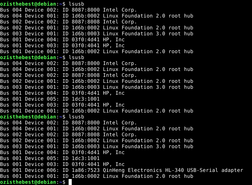

25 Nov 2022 04:07 #257594 by ChapEng
Replied by ChapEng on topic Pokeys
Thank you for the suggestions.
I tried upping the wait time (6000) and no luck. So I moved onto checking the lsusb (I am fairly new to linux, you've taught me a new command, though I should have had the troubleshooting foresight to google that one myself). I've attached my screenshot from the lsusb results, first iteration is without pokeys connected, second iteration the pokeys is connected (Bus 001 Device 005) but you can see it has no listed name. Suspecting that the device should have a name I connected my USB-RS485 module in the third iteration (B1D6). I tried a few different USB ports and had the same result with no name.
I've also included a text dump of "lsusb -v", if that is useful.
Do these results suggest there is something wrong with the library install and that linux isn't identifying the board properly (beyond "there is something there")?
Matt

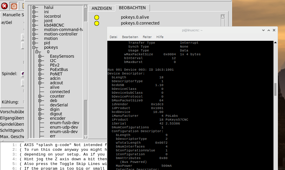

25 Nov 2022 10:53 - 28 Nov 2022 09:20 #257603 by zarfld
Replied by zarfld on topic Pokeys
So today i found some time to check this on my machine (raspberry Pi4).
i usually used Ethernetconnection, but on Pokeys57CNC i also have te possibility to connect via USB - which i did now.
and it is listed in output of "lsusb -v". - so i think that's a precondition to get the comp-file working.
for pokeys57U i'm not sure if it needs external powersupply, or try a different USB-port, and/or USB-cable.
just to be sure - i also updated pokeyslib as provided on bitbucket - and the compilation issue was reproducible.
(and i reported that to Matevz who seems mainting that library)
after applying the workaround described by "rodw" i can still get my comp-file working when connected using USB Port.
