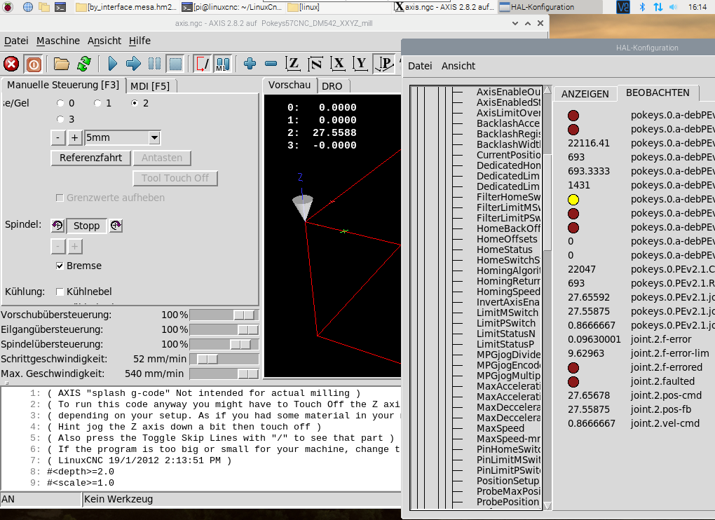

01 Jun 2022 14:17 #244373 by zarfld
Replied by zarfld on topic Pokeys ethernet
Hi
axis are finally moving ...
there is both PositionMode and VelocityMode...
i can get pos-fb based on "CurrentPosition" (divided by [JOINT*] STEPSCALE)
DemandValues for both modes share the same variable "ReferencePositionSpeed"
so first i was using Position-Mode which worked quite well, but without of adjustement of velocity
then i also changed to velocity mode - where i first thought i would need additional encoders to provide velocityfeedback for each axis.
but havinf vel-cmd and pos-fb signals active this seems fine also - besides a small deviation in pos-fb<->pos-cmd in 4th decimal.
so in the end i tried to switch to position-mode for the last move to ensure that the pos-fb is exact to pos-fb. but then the move was not fluent anymore.
so i removed that. I think the PID that you mentioned would also need vel-fb from encoders, right?
i tried to ensure a constant loopfrequency by counting the number of loops done every second (using realtime-clock signals of pokeys), and based on that adjusting the duration used in usleep(sleepduration). i found that "Device load status" on pokeys device kept the lowest if we keep around 10Hz, and the maximum frequency which seemed somehow stable was around 40Hz.
->kbd48CNC observed some latency issues if it is connected using Pokeys57E and PoNet-extensionBoard. This does ius not observed if on Pokeys57CNC (and CAN-operation enabled)
