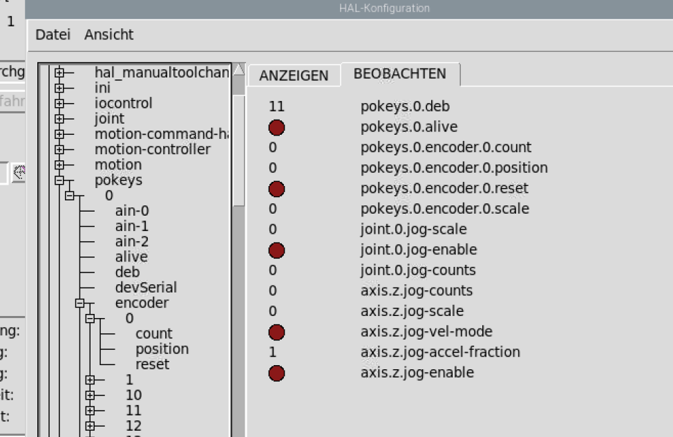

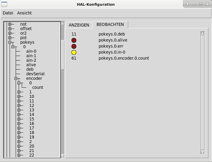

It seems to work!!!
The . alive is blinking,
.in-1 works also, the .deb is counting up and restarts every time...
.ain-0 with a poti works also...
and the counter works!!!
Big thank to you, Dominik!
Friday I set up a second encoder, I will tell you if all works!
Best regards
Marcel

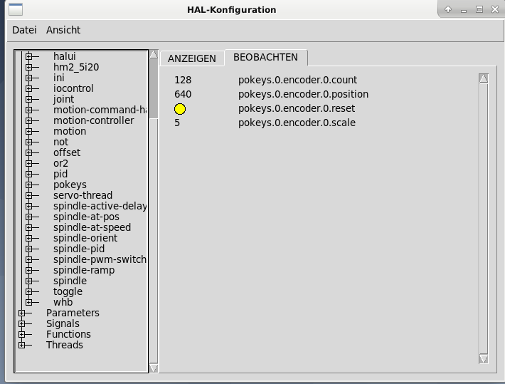

Hey Dominik,
tried it out, the .scale and .position works.
But the .reset dosn´t...
(I assume if I hit reset, the .count will be set to 0?)
EDIT:
I think it would be good, if the reset is be done at start of Linuxcnc...
If the last .count valvue was for example 10, at a restart of Linuxcnc it is 10, too...
So for my example to use it for feed-override, it is set at 110% at start of linuxcnc...
Best regards
Marcel

26 Aug 2022 17:08 #250534 by zarfld
Replied by zarfld on topic Pokeys
Hi Marcel,
sorry for my late reply. Now i also have my encoder wheel wired to my pokeys57CNC.
i think i found the problem.
(reset at startup is added also)
did you setup this encoder for jog-wheel operation or as position feedback?
BR
dominik
