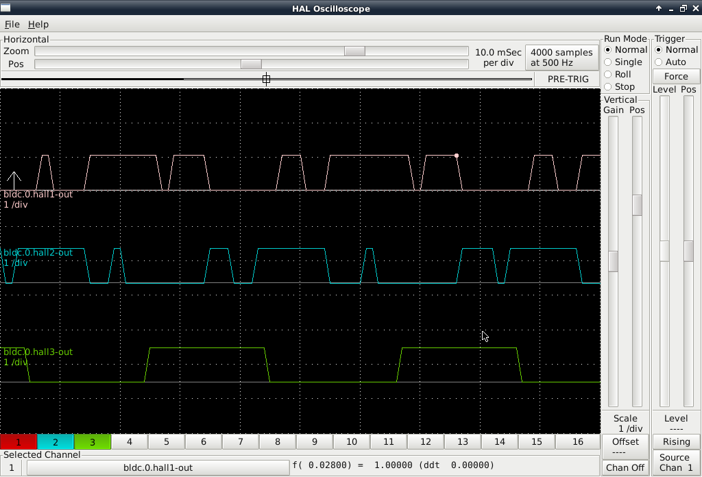

I took a 74ls04 and used it to buffer the encoder A and B channels, thus bringing them up to 5V level for the AMC drive velocity feedback input. This seems to be working nicely now. Didn't make any difference in the rough motor running though.
Just for fun, I hauled out my oscope and took a peek at the Hall1, Hall2, and Hall 3 outputs from the parallel port. I was mostly looking to verify a decent looking square pulse stream BUT..... The hall signals out are very strange indeed and probably causing my rough running. I am presently testing in straight code conversion mode, fanuc grey code to 3 standard hall outputs via BLDC. (cfg=fHT)
Attached is a screenshot of the 3 hall signals with the motor running approx 200 rpm. (guessing)
(I tried IRC hoping to catch Andy but no luck today)

200 rpm and at a guess, a 4-pole motor is 80 transitions per second, so your 500Hz sample rate ought to be high enough to see what is really happening.
Can you add the 4 Fanuc signals to the plot?
Replied by andypugh on topic BLDC and fanuc redcap parameter problems?

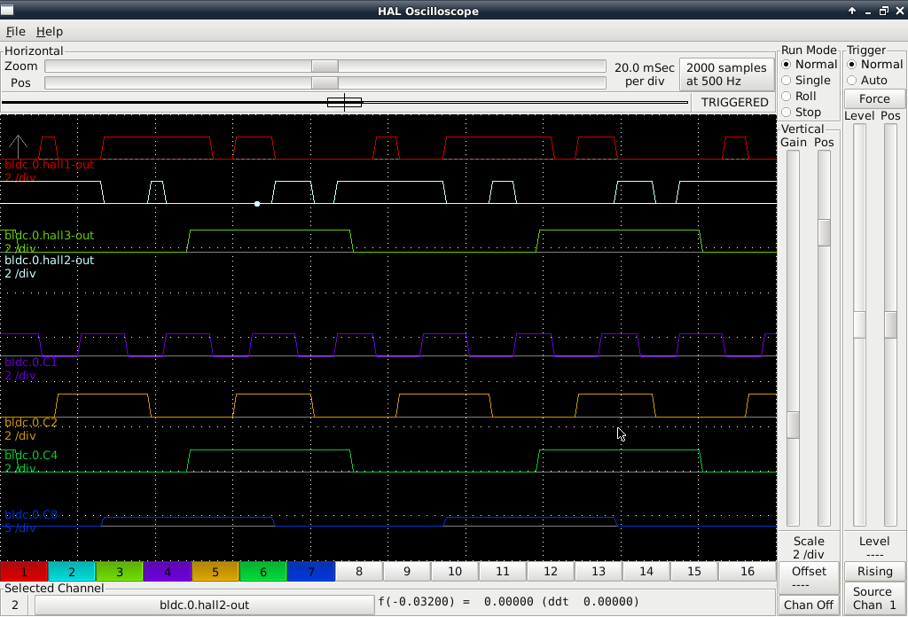

The redcap is a 8 pole motor. I will try and get a screenshot of halscope w the fanuc grey codes together with the halls.

Here ya go. Getting late so I will check back after work tomorrow.
Thanks Andy ! Much appreciated !

If you compare to
www.cnczone.com/forums/attachment.php?at...d=81300&d=1242252956
I think that your signals might be inverted.
Can you try connecting C1 C2 C4 C8 to the ...-not pins instead?

I shut down the shop for the night, early day at work tomorrow. The fanuc sigs are right off the pulsecoder and I verified them with a DVM against "watch pins" in hal monitor. I double checked that just in case I crossed any wires.
I will switch the fanuc pins over to the not inputs tommorrow and report back. I will grab a new screenshot also.
Thanks Andy !
