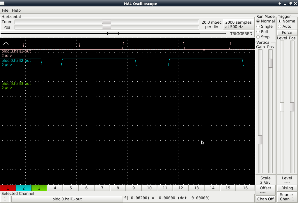

30 Dec 2015 19:34 - 30 Dec 2015 20:17 #67574 by gmouer
Replied by gmouer on topic BLDC and fanuc redcap parameter problems?
Ok, back to mode fqH Commented out the encoder offset line, got rid of that error.
Next error is bldc.0.index-enable does not exist. That seems strange, I did not comment that one out. I am assuming we NEED the index for referencing our commutation timing to the encoder.
I am beginning to see why nobody has ran a redcap like this before, but I don't quit easily
Commented out the bldc index enable , no errors now, motor jumps and then oscillates in place.
Added a screenshot of the hall outputs in this mode while motor is oscillating Its probably useless considering the motor is oscillating in place.
(also, a few steps back, I did verify raw encoder counts as 12000 by turning shaft, corrected hal bldc entry to 12000 before these tests)

30 Dec 2015 20:12 - 30 Dec 2015 20:46 #67576 by gmouer
I am still confused why the pin bldc.0.pattern does not exist ! According to the BLDC doc, as I read it, it should be there. Maybe this is why I am oscillating, bad commutation pattern and I cannot set one. (other than bldc.0.output-pattern which is only used for the signal translation function as I read it)
What is up with this?
I read the old emails John Sheerin gave me when you worked with him on his redcap. My drive is in velocity mode, speed being controlled by a pot, does bldc need to have control of motor speed / position for my tests? The old emails raised this question.
Last edit: 30 Dec 2015 20:46 by gmouer.
