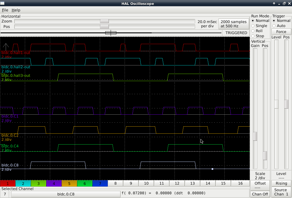

29 Dec 2015 16:19 - 29 Dec 2015 16:22 #67469 by gmouer
Replied by gmouer on topic BLDC and fanuc redcap parameter problems?
Does not seem different with fanuc gray codes routed through inverted input. Motor runs identical also.
( I attached to the -not pin of C1-C8 in BLDC first try, same results, so I tried -not of the parport instead)
Hal file attached

29 Dec 2015 17:44 #67476 by andypugh
Replied by andypugh on topic BLDC and fanuc redcap parameter problems?
No, it seems surprisingly identical. There isn't even any indication that the Fanuc signals have changed sign. (on a falling edge of C8 all the other signals are exactly in the middle of a high phase, in both traces.
If you tried bldc.0.C1-not and the system ran then I suspect you are not editing the active HAL file..
That should have been an immediate crash.

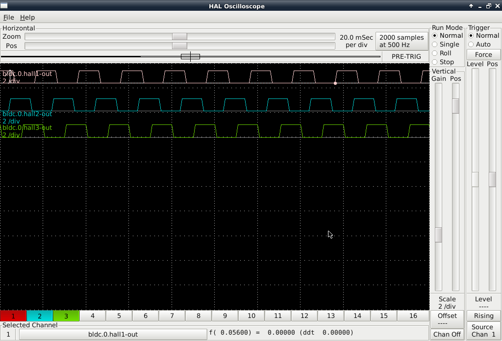

29 Dec 2015 18:18 #67479 by gmouer
You were correct, it was not the active hall file !!! I configured the launcher wrong. I fixed that and confirmed I am working with the active hall file now. Sorry about that.
Using the -not option on the BLDC C1-8 pins does indeed cause a crash, so I reverted to using the -not on the parport input pins. The halscope hall signals now look proper for standard hall commutation !! The motor runs much faster but not very smooth. Now that I have a good commutation pattern, its time to try different hall sequence patterns for smoother running. Agree?
I seem to have also lost velocity control, acting like a run away condition. Went back and removed the -not pin change and fine speed control returned. Something strange there but the commutation pattern looks more like it.
29 Dec 2015 18:26 - 29 Dec 2015 19:10 #67480 by gmouer
addl info
Switched to pattern 25 which cured run away type condition and restored fine speed control. Of interest is that motor runs considerably smoother in one direction vs the other. In the smooth direction it is the best yet by far.
Need to try all the patterns.
Update: Pattern 17 is the winner, great torque both directions, velocity loop in drive maintaining speed under load changes, behaves the same in both directions of rotation, speeds up well. Only complaint is cogging sound is quite apparent but no doubt that is because of 16/3 problem yielding slightly imperfect commutation.
I believe this is probably as good as it will get using straight code conversion mode. Time to move on now to encoder derived commutation I believe.
