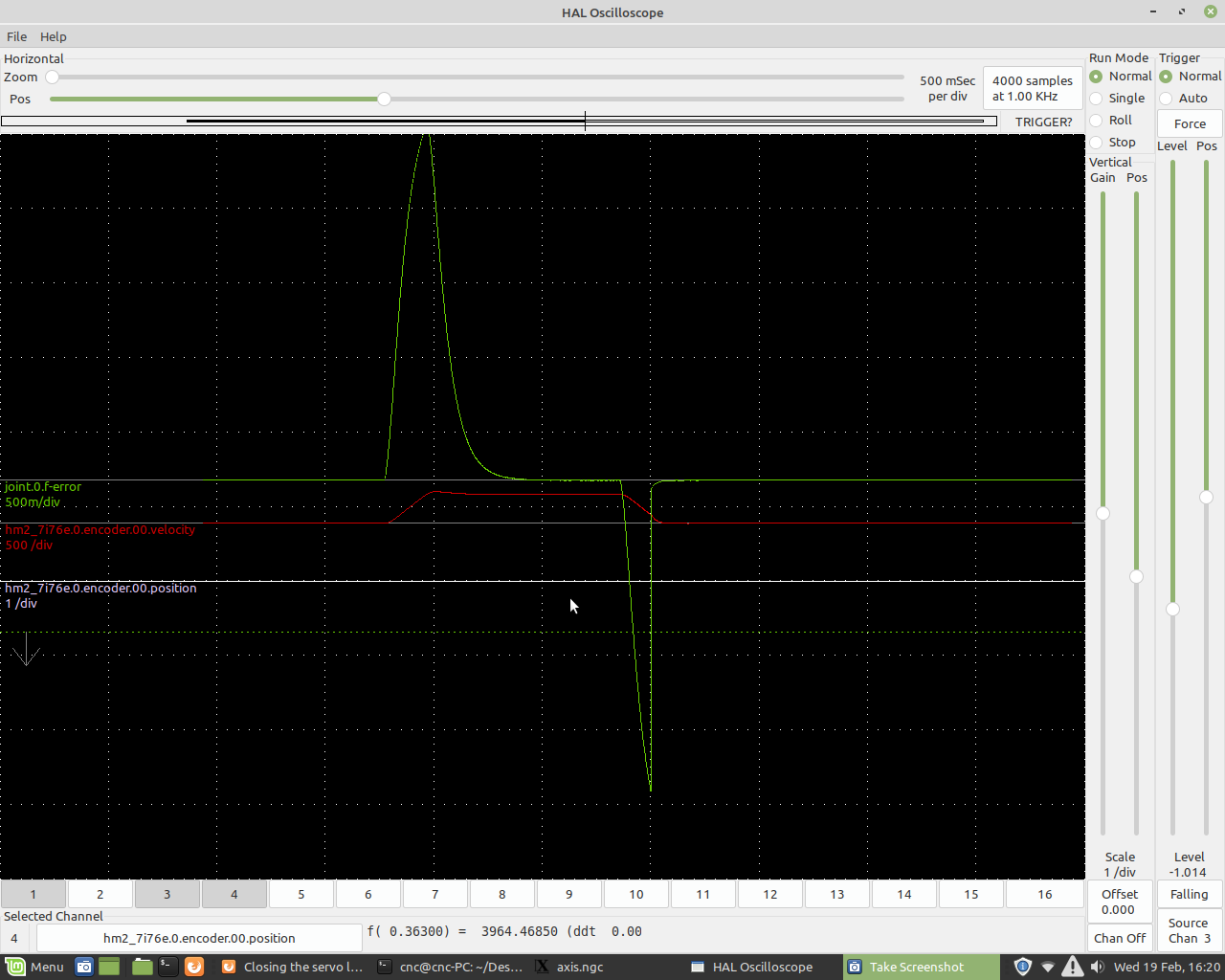

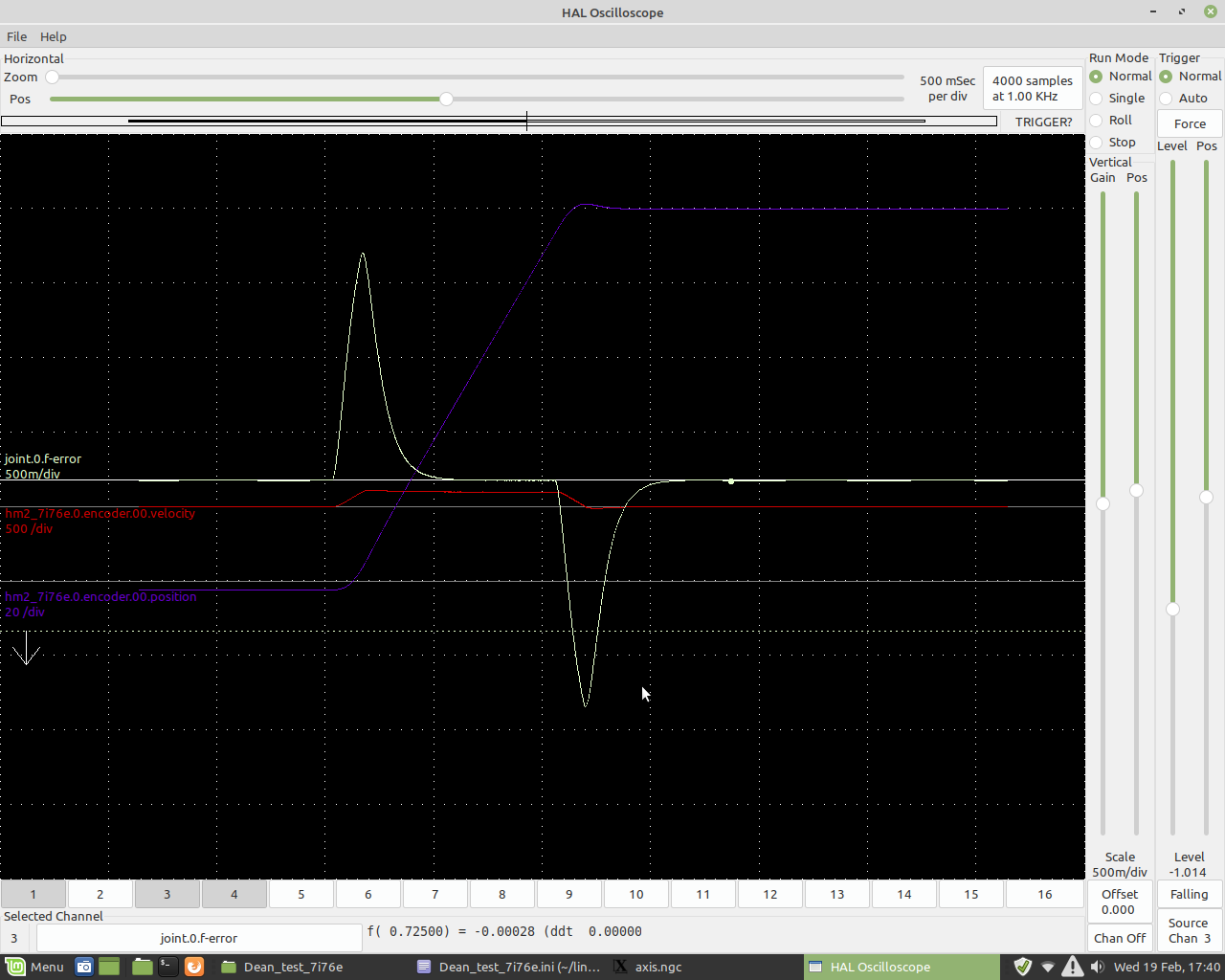

Now I have delved into the mystery of hal scope
Does this help. Triggered from following error
Not sure if I have done it correct

19 Feb 2020 16:45 #157871 by Todd Zuercher
Replied by Todd Zuercher on topic Closing the servo loop with HAL mesa 7i76
From that image it looks like one of two problems (or a combination of the 2). Either you need alot more P (you have P=10 now) or your motor/drive can't match the max acceleration settings you have set in your ini file.
19 Feb 2020 17:03 - 19 Feb 2020 17:05 #157874 by Clive S
Replied by Clive S on topic Closing the servo loop with HAL mesa 7i76
The motor and drive are a matched pair. this only happens in closed loop.
I will experiment with the P (perhaps I should give it some of my tablets for my P) B)
Thanks for the interest.

19 Feb 2020 17:08 - 19 Feb 2020 17:14 #157876 by PCW
You only _see_ the error in closed loop. its very likely its still there in open loop mode, but not detected
To me it looks like Todds second suggestion, you are exceeding the drives acceleration settings

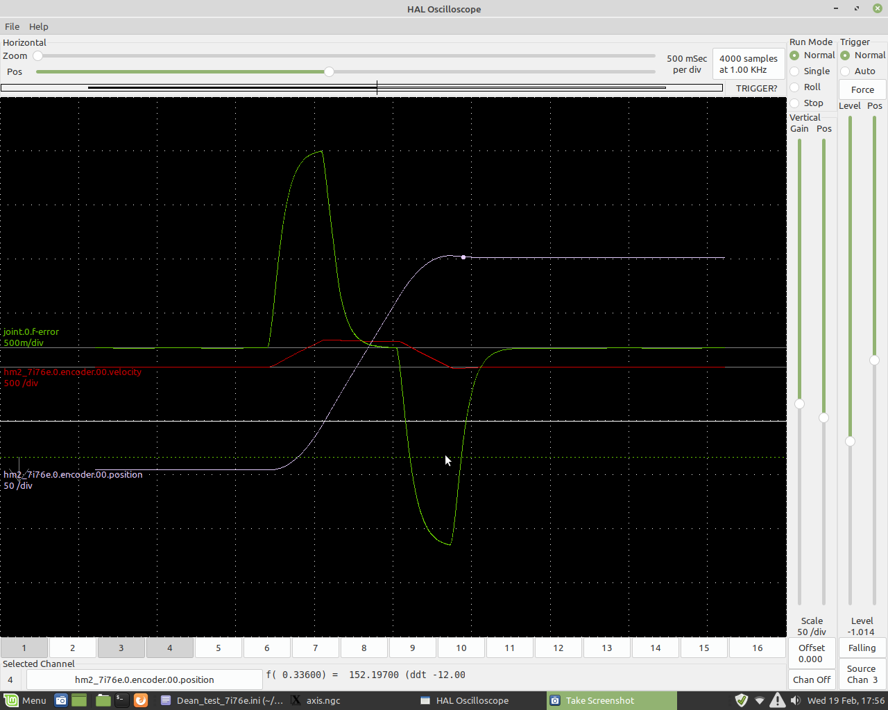

19 Feb 2020 18:04 #157879 by Clive S
I have lowered the excel to 700 from 1000 are these looking better
Jogging at 1450mm/min not sure what to look for in the plots, but I will have a look at this link from Tom
forum.linuxcnc.org/10-advanced-configura...ning-detailed-how-to

19 Feb 2020 18:11 - 19 Feb 2020 18:15 #157881 by Todd Zuercher
Try something more like 200mm/sec/sec. (You probably should use your servo drive's configuring software to increase the acceleration there or at least look up what it is set for, there is no reason to be guessing at these numbers.)
