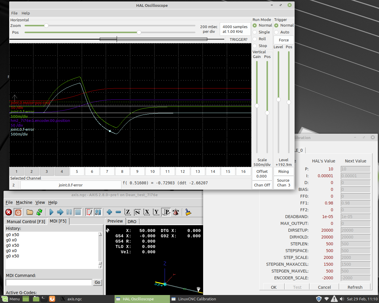

OK I have had a chance to try and tune the servo fro the following errors. (The motor is on the bench)
Re: the screen shot what do I need to adjust and what should I be looking for?
This was moving at about 50mm 14000m/min

29 Feb 2020 11:31 #158806 by thefabricator03
Replied by thefabricator03 on topic Closing the servo loop with HAL mesa 7i76
Since changing the settings in the drive, are you still getting following errors?
29 Feb 2020 14:21 #158812 by tommylight
Replied by tommylight on topic Closing the servo loop with HAL mesa 7i76
Close but no cigar ! :)
At that speed you are still getting about 400ms of total delay.
Have a look at the first post here, where the wiring ends and the tuning starts, right above the :fine tuning: part.
That should get you very close to acceptable very fast.
forum.linuxcnc.org/10-advanced-configura...ning-detailed-how-to
29 Feb 2020 15:00 #158814 by PCW
The fact that you are getting huge errors (> 1.5 mm) means the drive tuning is still way off
Did you set all the drives filter time constants to their minimums?

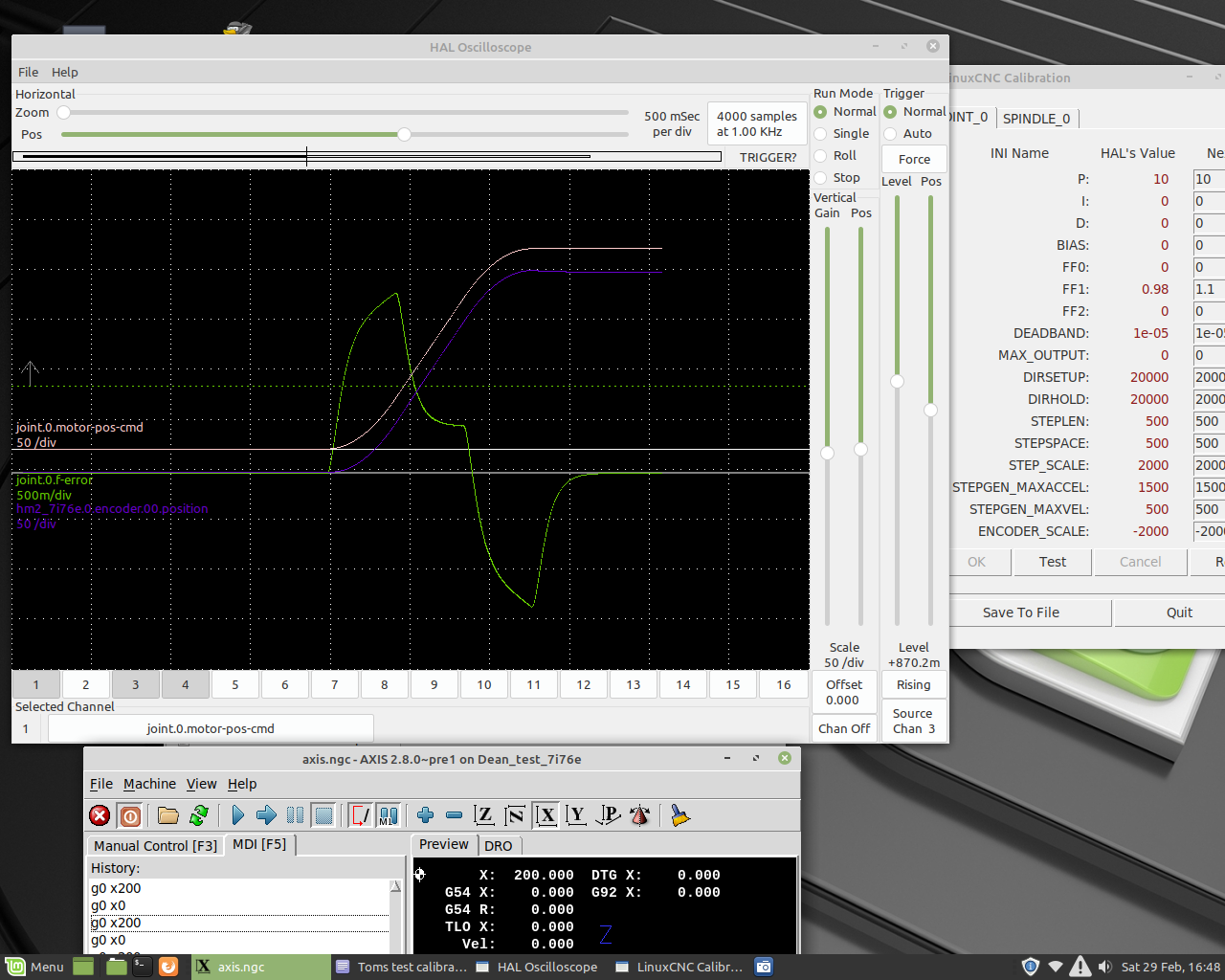

New plot over 200mm

01 Mar 2020 02:45 #158861 by PCW
I would set Pn110,111,112,114 to their minimums and see if that improves the tracking

01 Mar 2020 11:04 #158883 by Clive S
Replied by Clive S on topic Closing the servo loop with HAL mesa 7i76
Peter many thanks for looking into this.
Pn109 is set for zero which I think disables Pn110,111,112 not sure if it affects 114.
But I will of course try those settings.
