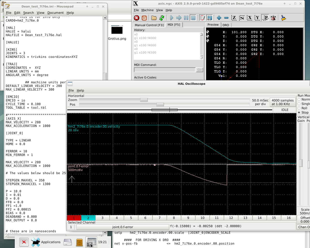

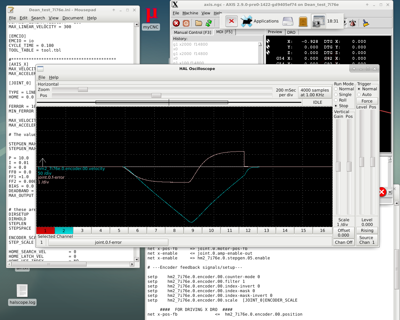

Ok After setting up another machine. I have now returned to the F-error problem.
To re-cap this is a 1.8kw servo with matching drive just on the bench it does not error at 3M/min but does at 4.5M/min.You can see from the GUI that it has over shot by 1mm when it error ed
What do I need to adjust and in what order to sort this.

Replied by PCW on topic Closing the servo loop with HAL mesa 7i76
You can see from the encoder velocity lagging the error that the drive has significant delay
from the command ( the commanded step rate determined mostly by FF1) and motion.
It looks like about a 20 ms delay (1/10 of a major division).
Unless this delay can be eliminated I suspect those drives will not be useful with external feedback.
(and may be a bit suspect as far as axis/axis coordination goes)
That said, is P as high as it can go without instability?
a larger amount of FF2 may also help
Plotting the commanded velocity would also help diagnosis
