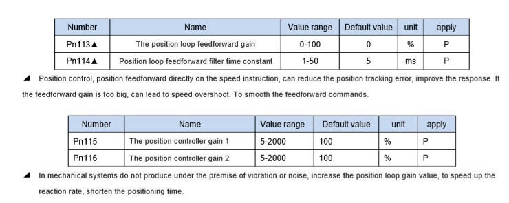

22 Feb 2020 15:20 #158212
by Clive S
Replied by Clive S on topic Closing the servo loop with HAL mesa 7i76
- Todd Zuercher
- Posts: 4786
- Thank you received: 1476
22 Feb 2020 17:45 #158224
Replied by Todd Zuercher on topic Closing the servo loop with HAL mesa 7i76
Those pertain to tuning the position loop in the drive (something that may need done). But not directly to the velocity or acceleration limits.
