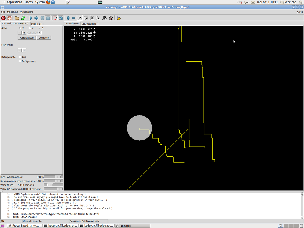

23 Nov 2011 09:35 - 23 Nov 2011 09:40 #15042 by dab77
Replied by dab77 on topic Re:joystick jogging into world mode
andypugh wrote:
Can you try your joypad setup with trivkins, then set trivkins to KINEMATICS_BOTH and see what happens?
(I might try the same thing myself, but it's all a bit awkward with my computers where they are at the moment)
Ok, today i could do that. ...and...now i can exchange between joint and world mode into trivial kinematics, but the problem remains the same.
to clarify i took a snapshot of what happens if i try to move the two axis toghether triyng to obtain a diagonal movement:
i really don't think it is a kinematics problem.
it seems to me that the part of program which reads the joystick, when into world mode can read only one input at a time. But i don't know which is the part of program..
davide.

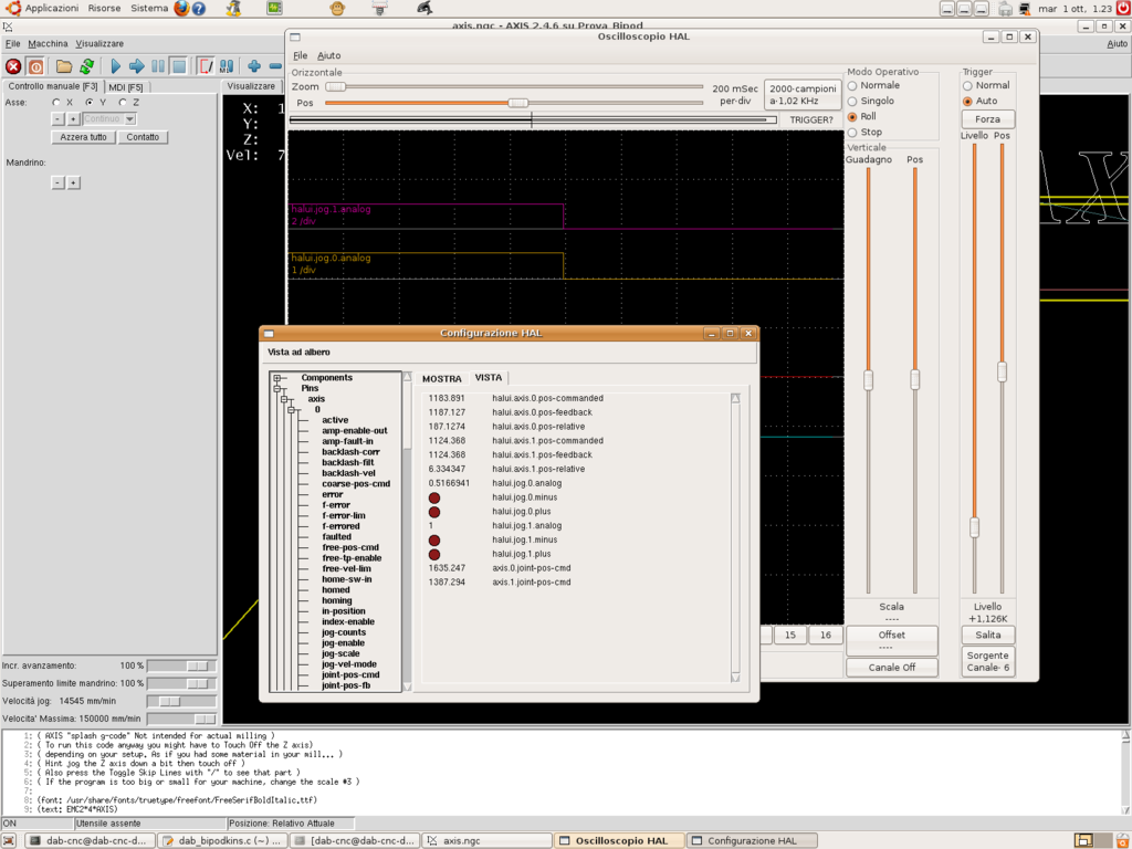

23 Nov 2011 10:52 - 23 Nov 2011 10:56 #15044 by dab77
I took another screenshot, now using bipod kins:
Here what you can see is that i'm moving joystick in diagonal (in the moment of the screenshot analog X is at 0.51, while analog Y is at 1.0)
what you can't see in a picture is that halui.axis.0.pos-xxx are moving, while halui.axis.1.pos-xxx stay the same. (in fact i can see a movement only in the X direction..)
i can't find other useful things to measure here.
but one things that came in my mind is that it could be that for joystick input, there is a sort of "halui.jog.selected_axis" that make the program choose for one axis to read at a time. i've looked between all the pins and signals, but cannot find anything similar.
do you think it can be like that? (i wish i could explain what i was thinking..sorry for my limitated english..)
davide.
Last edit: 23 Nov 2011 10:56 by dab77.
