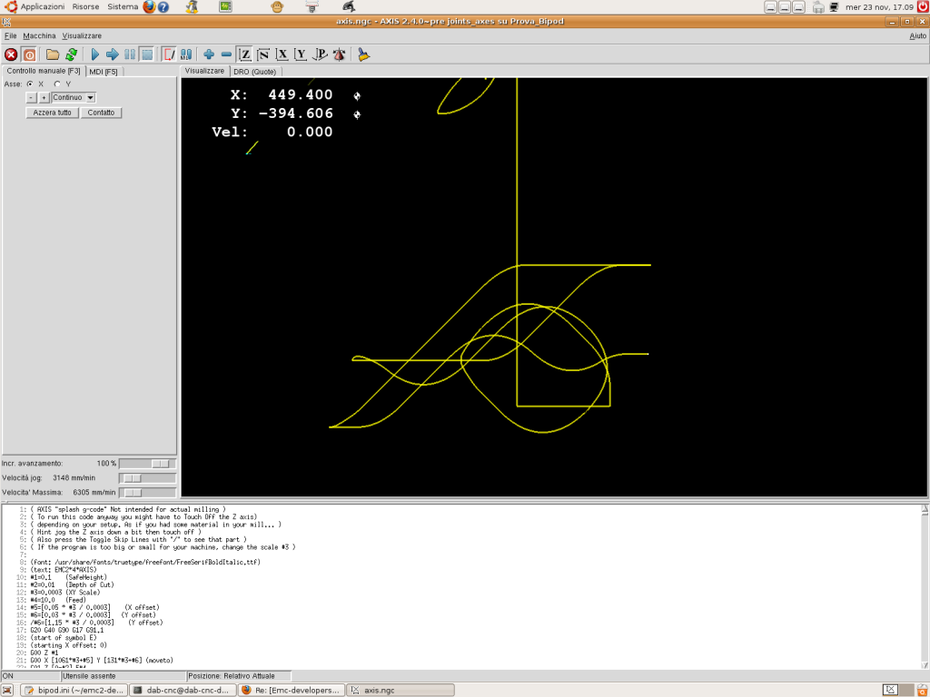

23 Nov 2011 16:21 - 23 Nov 2011 16:26 #15057 by dab77
YEEESSSSS!!!
Ok Andy and other interested, i almost solved the question!
i tried again (one year ago my first attempt, but i wasn't able to accomplish..) to install joints_axes3 branch... not so simple for me, but this time i could do.
modify my .ini and .hal bipod files and...
let's say that it can read two analog joystick directions together. I have only one problem now, that it reads only the maximum value of the analog joystick. to explain: as i touch the joystick in X direction, the system move into the right world X direction, but at max speed, as if i pressed the joystick at the maximum. Then, as i move simultaneously to the Y direction, the system goes to X,Y in diagonal at maximum speed.
i think that's a problem with the configuration file of Joyhandle.

15 Dec 2011 17:02 #15708 by dab77
Hi, some days ago i could finally solve this problem, and for everybody's knowledge (of course who cares or needs..) i'm writing here how.
It was finally possible thanks to Michael Geszkiewicz suggestion on the devel-mailing-list:
If you want to make halui.jog-speed pin working in ja3 branch, comment
line 1223 (axis->teleop_tp.max_vel = axis->vel_limit;) in file
/src/emc/motion/control.c and recompile
regards,
Michael
This solution interests those who need to jog with a joystick/joypad with non-trivial kinematics into world-mode (teleop.).
The issue with master and older EMC2 was that it was impossible to jog 2 or more axis together.
Instead with JA3 branch, as it is, you can jog, but with a costant speed (no manual control of speed).
Thanks to Michael mod that is possible.
soon i'll put a video to show this.
Ciao, Davide.
