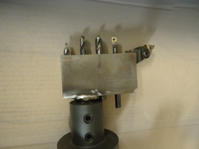

18 Oct 2013 19:44 #40039 by jtc
Replied by jtc on topic Current turning capabilities status
Thanks andypugh, we just limit the speed and acelaration on the drive. for now just works fine.
So, the current status of the machine is: we have almost the hardware needed to complete the machine and at this point we have to start testing seriously linuxcnc capabilities.
for now there are 2 problems. in the axis gui, the plans is to invert the X axis, not inverted by geometry (already make this in Z axis), but on the screen itself. now the X axis is below then the centrer line(Z axis), but we want that in the upper part, just above Z axis.
the second problem, for example, we have a holder that use more than one tip, like this:
is this possible? how can it be defined in the tool table? can have more that one tip per pocket?
Tnks,
João
18 Oct 2013 20:29 #40040 by andypugh
Replied by andypugh on topic Current turning capabilities status
In this thread: www.linuxcnc.org/emc2/index.php/english/...tools?start=10#24959 it was discovered that using coordinate-system rotation works well.
Unfortunately not. Which is rather irritating. The next version of the tool table will support this. (If my changes are accepted). But this is likely to take quite a long time.
A workaround may be to configure your toolchanger in such a way that pockets (or tools) 001, 101, 201, 301 etc are all interpreted as being in the same place on the tool carousel.
I have a feeling that, contrary to what the docs say, the "Pocket number" in the current tool table can not be > 56. However I _think_ that it is possible to configure a tool-changer to act on the value on the tool-number request rather than the pocket number request.
