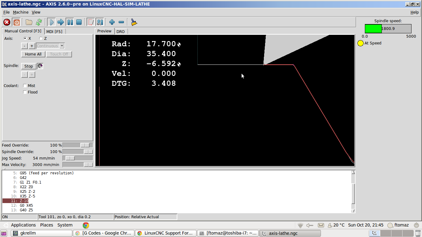

Today I tested how the CSS works and the tool compensation modes. Both are important for my use.
All tests were done on simulation.
The CSS appears to be fine, but the compensation probably have some issue that I do not understand.
I tested the simple code below:
Nothing strange about it. The tool 101 is well defined with a radius of 0.2mm (that on the tool table is supposedly to be in diameter. The value on the tool table is 0.2 and seams to be ok). The problem is that as can be seen on the picture attached, that the movement from point X35 Z-5 to point X35 Z-10, the machine is in diameter X35.4 instead of X35 (I know that 35.4 = 35 + 0.2 + 0.2 that could be related with the tool radius).
If the movement is along the Z axis, the commanded position in X should match the tool position even if the compensation is on. In lathes the DRO should display the imaginary tool tip. It looks that the DRO is showing the tool tip center like in mills, that is inappropriate for lathes.
Can someone please inform if G41 G42 is really working as stated on several linuxcnc documentation for lathes? I am not sure if I am missing some config.

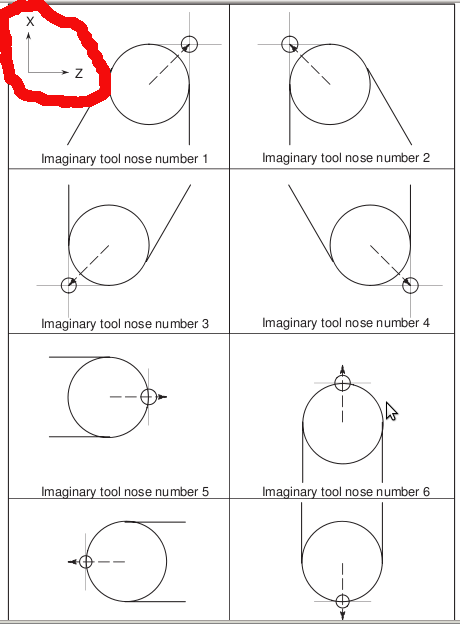

The same error is here:
wiki.linuxcnc.org/cgi-bin/wiki.pl?Lathe_Advanced_Features
and the correct tooltip direction can be seen on the file attached.
21 Oct 2013 05:41 #40108
Yes, definitely and absolutely.
Is it possible that you are not in the XZ plane?
Replied by andypugh on topic Current turning capabilities status
21 Oct 2013 08:24 #40115

21 Oct 2013 18:41 #40124
When I have used G42 on my lathe it has definitely worked correctly. I don't normally bother, as you have said, it makes no difference on straight facing or diameter cuts.
I need to spend some time with a LinuxCNC machine in front of me to see what does what. (currently I am at my day-job with a Windows machine).
Are you using the Rogge patch? I see that you are not using G43 after a tool change to load the geometry. This is normally required.
I think that the problem is that you are using Tool orientation 3 when you should be using 2. If you look at
www.linuxcnc.org/docs/html/lathe/lathe-user.html
You will see that Orientation 2 is the direction that points in the -Z and -X direction. You need to flip the picture if you flip X.
(Somewhere I have seen a document, Possibly the Fadal manual, that had different diagrams for front-tool and back-tool cases.).
I think if you set the tool as a type-2 and reload it (G43) you should see the correct behaviour.
