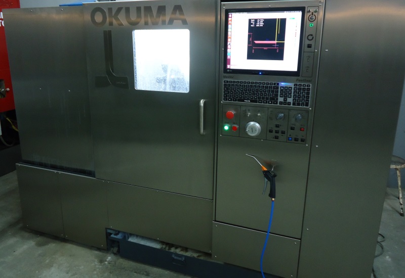

12 Apr 2014 19:22 - 12 Apr 2014 19:25 #45882 by emcPT
Replied by emcPT on topic Current turning capabilities status
Some work being done:
Some small issues are not completely done (we were unable to produce what we want), so if anyone can give me a good way to atchieve the following (or just one point):
1) I normally do repeative work, and the toolpath preview stays with the last run part on it. I have to "clean the toolpath" before I start again a new cycle. Can this be automatically (when a new cycle start, the toolpath is also cleaned from the previous made part)?
2) I have a physically start and a stop button. I want that the stop button do the following: If the machine is running, when the user presses the stop, the machine makes a pause (feedhold) with the spindle rotating, if the user presses again the same button, it should be equal to cycle stop. The first was done, but we were unable to give a second functionality to the button based on the condition that I described.
3) Also, I have a feed override button, that works very well (0 to 200%). The button is only able to override the G1,G2,G3 movements, not the fast movements G0. My interest is to give the ability for the user to control both feedrates from the same button. This is very usefull to test a part, were the proximity movements are in general all made by G0.
4) We use a touch screen. All works good, but the buttons on linux (not only in linuxcnc) are very small. The top bar, when I want to close for example the text editor is hard to press (I press all around it except the button that I want :angry: ). For linuxcnc itself Gmocapy will probably be a solution that I did not yet tested.
Last edit: 12 Apr 2014 19:25 by emcPT. Reason: Video was not present
12 Apr 2014 19:44 #45884 by andypugh
Replied by andypugh on topic Current turning capabilities status
Possibly, it is possible to do it from a script
linuxcnc.org/docs/html/man/man1/axis-remote.1.html
The remainder of the puzzle is how to do it from HAL (or possibly from G-code)
One possibility is to have a custom M-code to call a script that clears the display. This would need you to insert that M-code in the G-code file.
www.linuxcnc.org/docs/html/man/man9/multiclick.9.html
I think you can do that by changing the max-velocity rather than the feed-override. In the "Touchy" interface this is part of the UI. I am not sure which UI you are actually using.
4) We use a touch screen. All works good, but the buttons on linux (not only in linuxcnc) are very small. The top bar, when I want to close for example the text editor is hard to press (I press all around it except the button that I want :angry: ). For linuxcnc itself Gmocapy will probably be a solution that I did not yet tested.[/quote]
Have a look through the "themes", there might be a more touch-oriented one.
