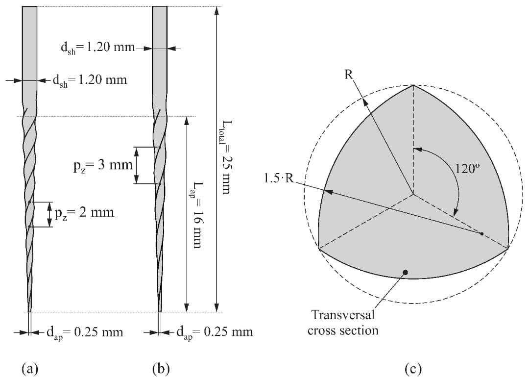

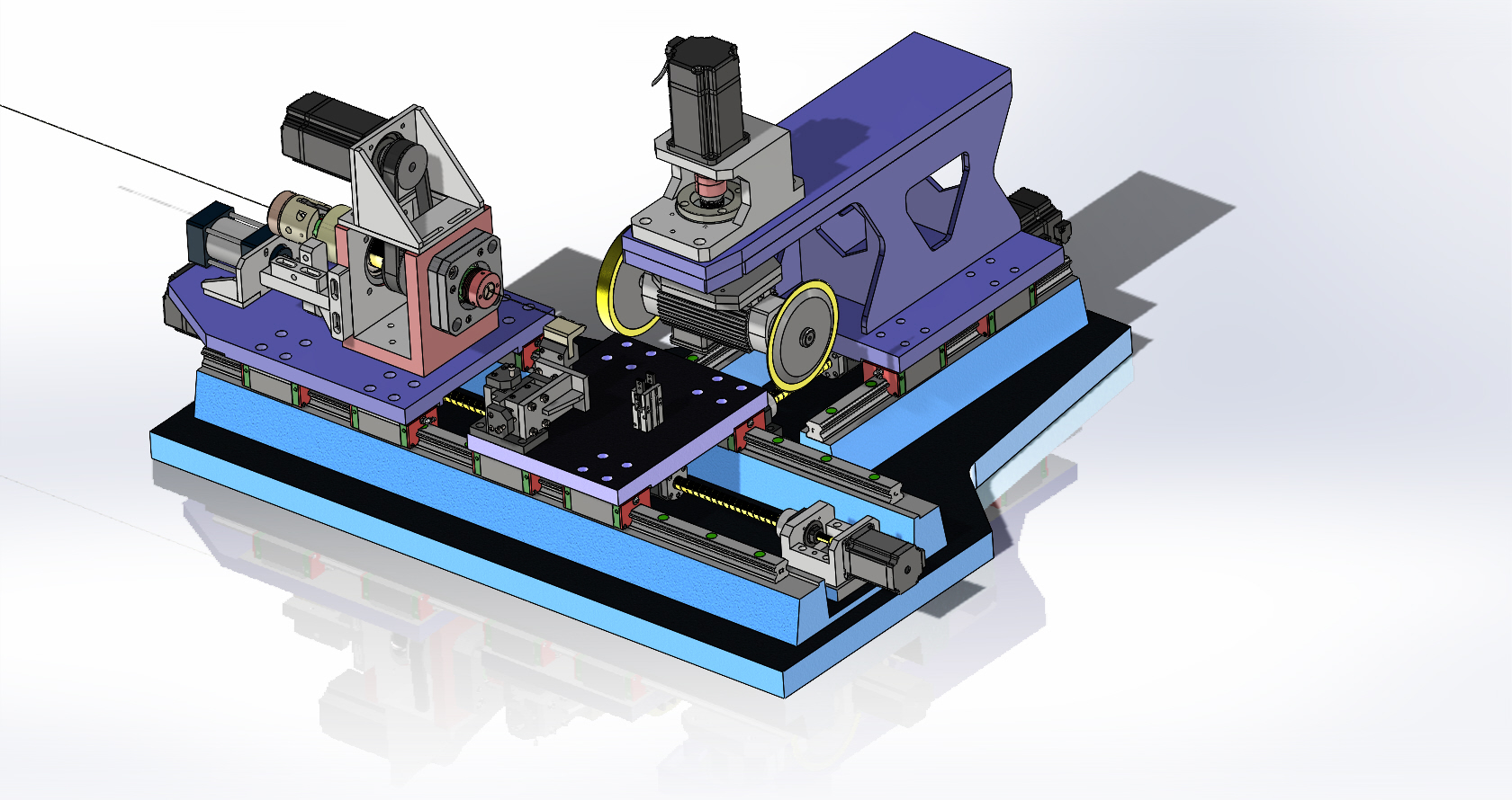

02 Apr 2023 15:00 #268078
by mehdidadash
Replied by mehdidadash on topic eccentric turning
Hi dears. I am designing a machine to grind the component in the attachment.
i have attached machine design too. It has this axes;
X(radial )
Z(axial)
B( i may remove this, i added it in a conservative move)
C( workpiece spindle, servo driven)
I want to write a hal to sync x, z, c axis together.
i have mathematical formula for all of surface and i have writen a code to generate a gcode for this.
MY servos are all delta asd-a2L ethercat.
But best move will be syncing x, z, c together in a hal file like what you have written here.
Where should i start?
I have a very good mathematical background but started coding just recently.

Consider that for every point of contact between wheel and workpiece, we know a tapered helical path. The path has this form:
x=f(c)
Z=g(c)
c=c(from 0 to n*c)
SO i have written a function that generates g code like this:
G01 Xf(0) Zg(0) C(0) F400
G01 Xf(10) Zg(10) C(10) F400
And continue to add 10 degrees to c in every step until it reaches the end of component.
But it does not have required accuracy.
So i wanted to write a hal component to link this three axes together.
How should i start ?
Would you give me a starting point ?
x=f(c)
Z=g(c)
c=c(from 0 to n*c)
- Posts: 19896
- Thank you received: 4648
02 Apr 2023 15:45 #268084
Replied by andypugh on topic eccentric turning
This feels a lot like:
However, you would need the relief grind to vary with Z axis movement, according to the flute spiral angle.
I actually did that relief turning using the "hexbore" component that is also used for the hexagonal boring demo.
This is the HAL component (And the part of the HAL file which connects it).
For grinding spirals I would suggest adding two more pins, one to receive the absolute Z position and another that gets the tangent of the flute angle (no point working out the tangent in the realtime thread, it doesn't move)
You can remove the sections that are active if relief == 0, those are for polygon mode.
And the HAL file:
