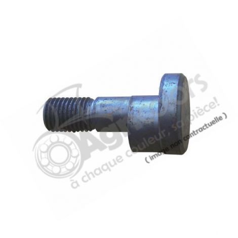

The goal is mostly to allow me to easily turn some eccentric screw. (polygon is also something i like to be possible to do)
